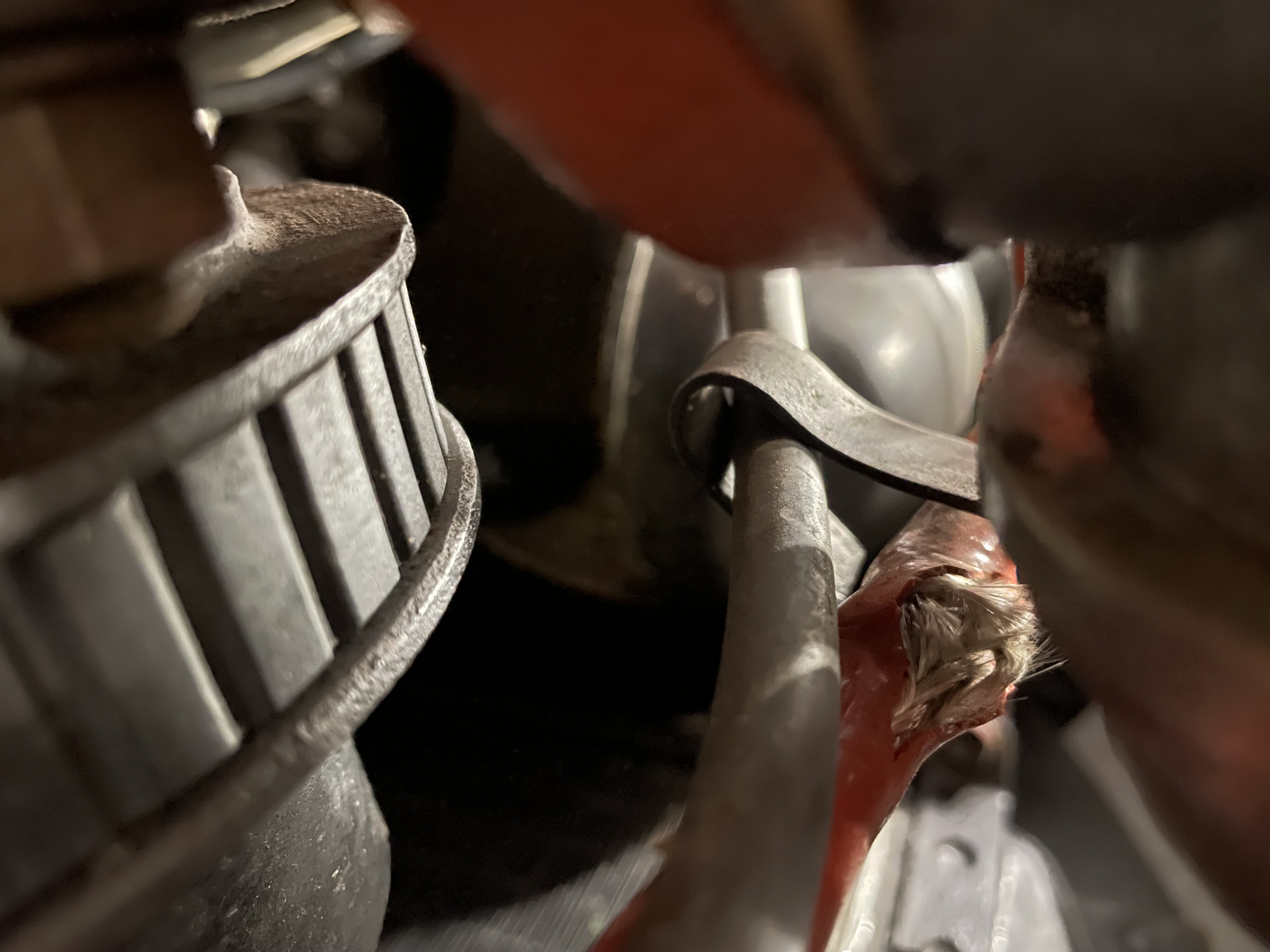

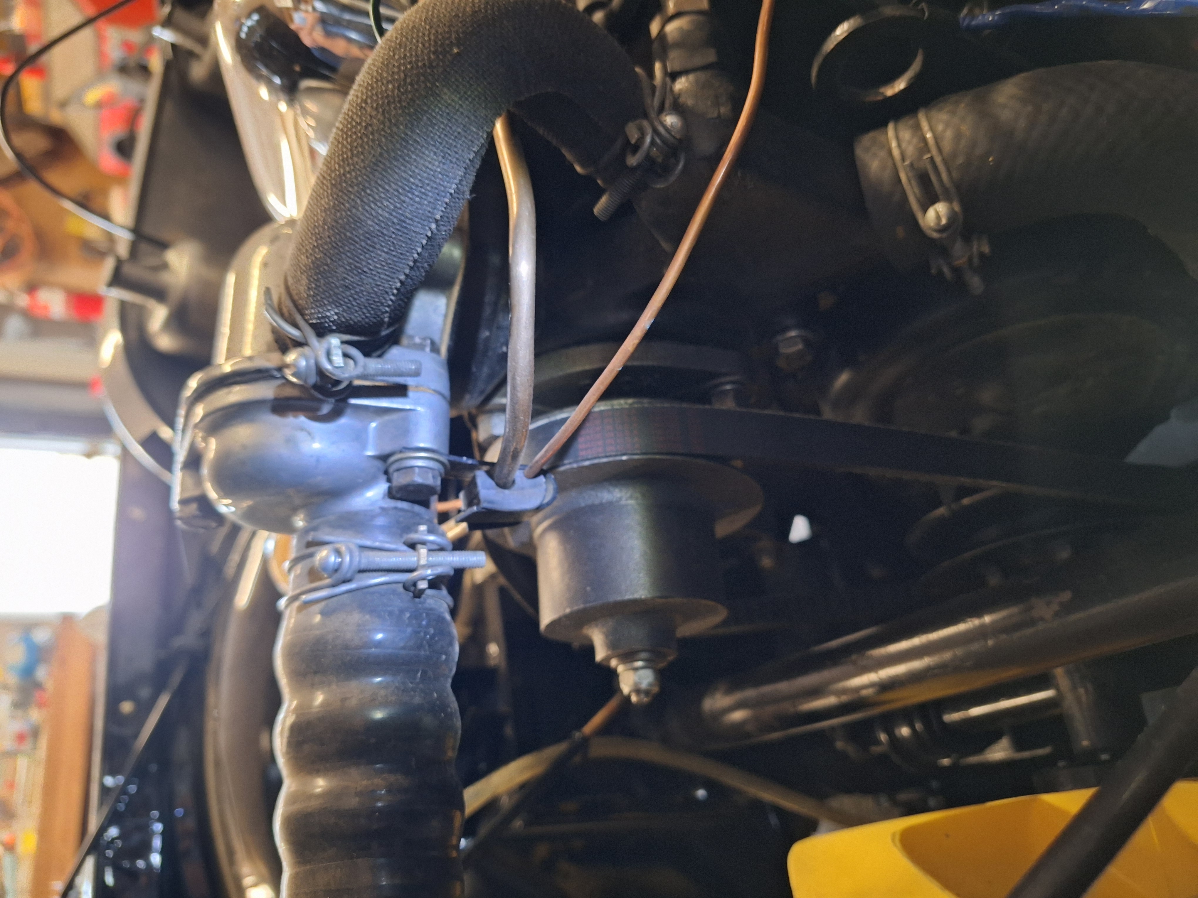

It should be the same as the 3a. There’s a clip on the front of the thermostat housing that holds the vacuum line and the fuel line “more firmly” above the fan belt. Hope these pics help. There is also a rubber bushing that holds both lines in the clip (Moss 680-755)

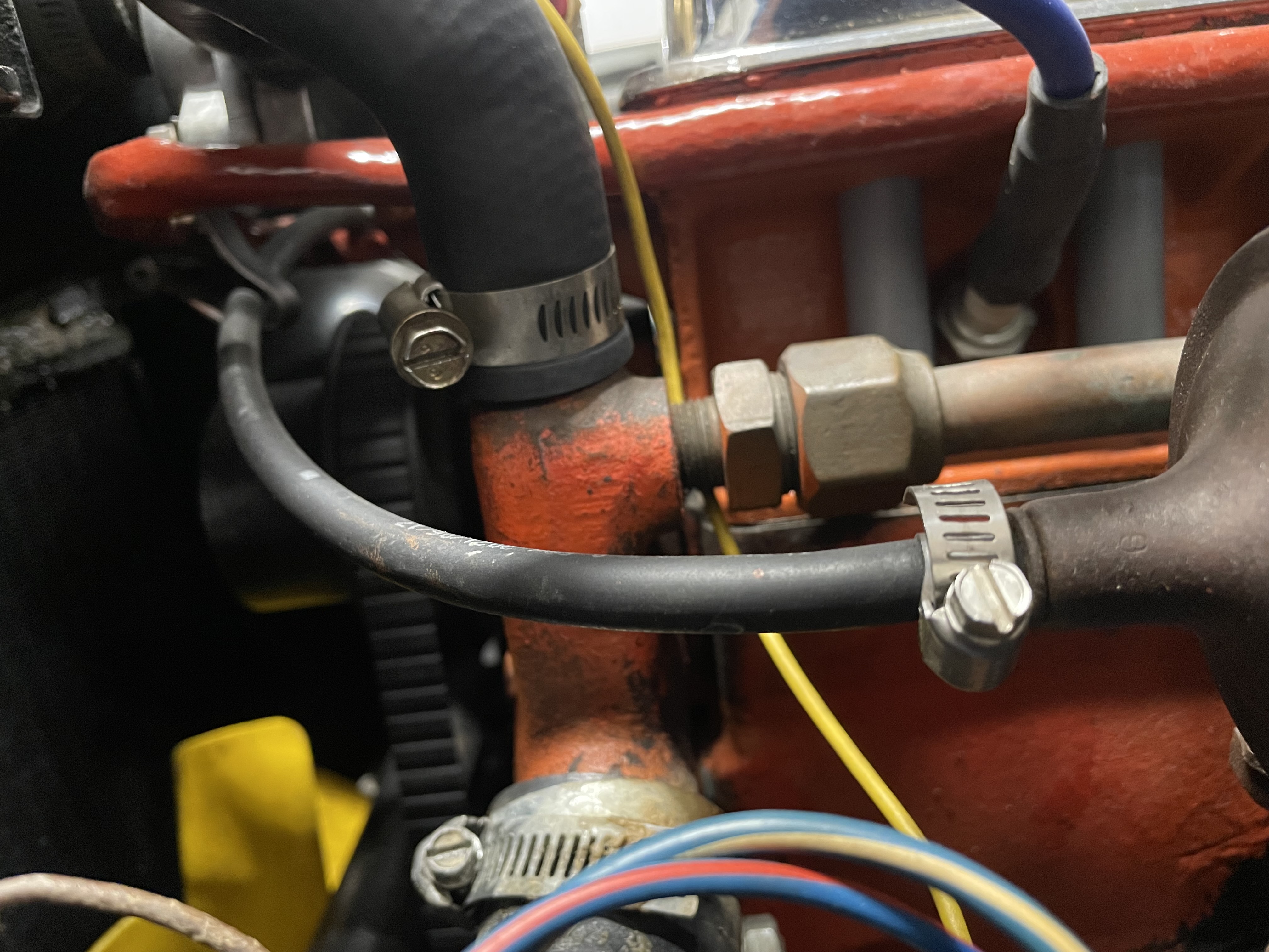

Thank you very much. I don't seem to have that clip on the front of the thermostat housing that holds the vacuum line and the fuel line. Also, my fuel line is located in the space between the thermostat housing and the valve cover. Not sure if this was a change made with the TR3B/TR4.
My engine is a TR4 (CT…) and has the clip but my car is a bit of a frankenCar and have a TR4 thermostat housing and probe. BTW that red sheath is a flexible heat shield covering my fuel line from the pump to the carb and between the carbs.

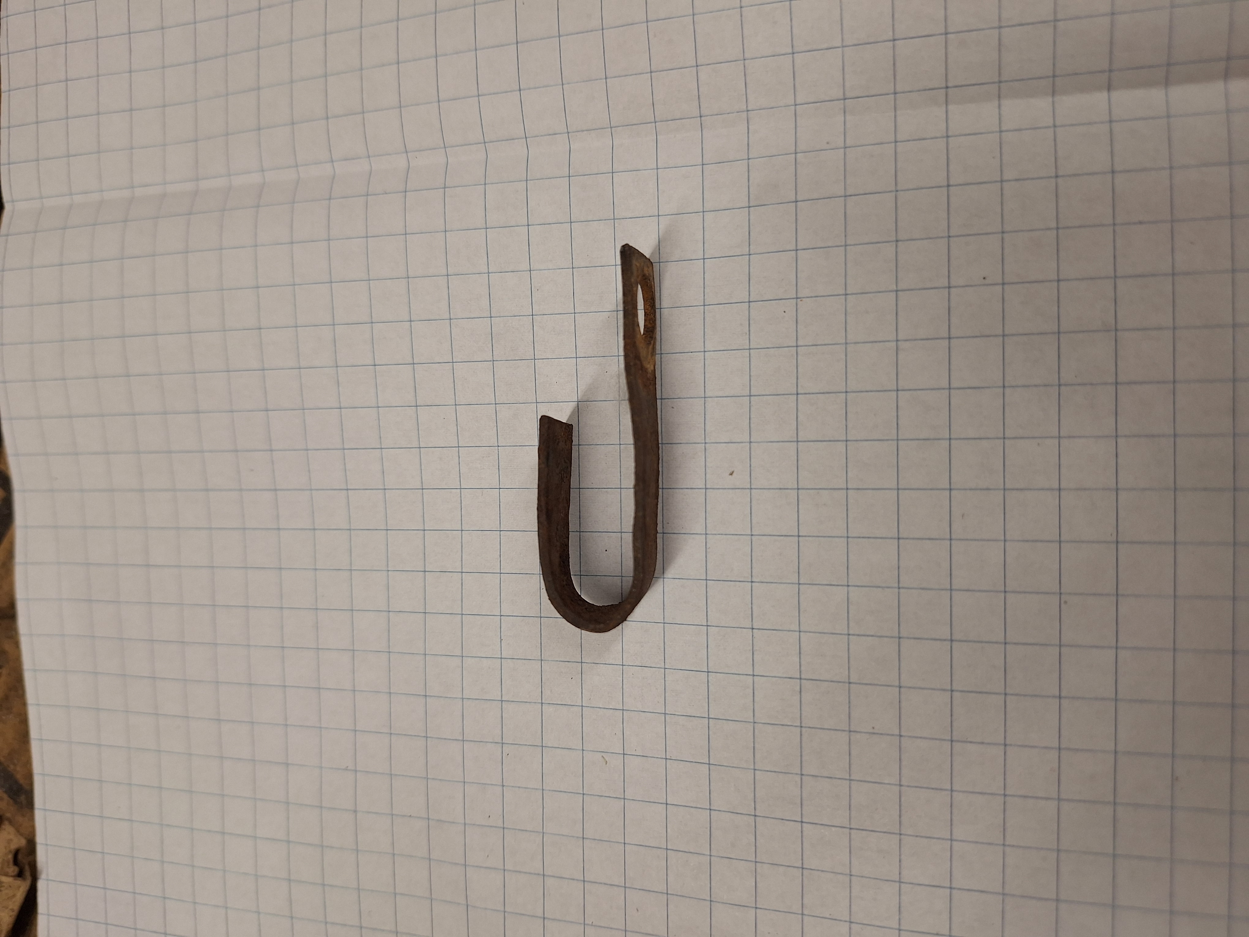

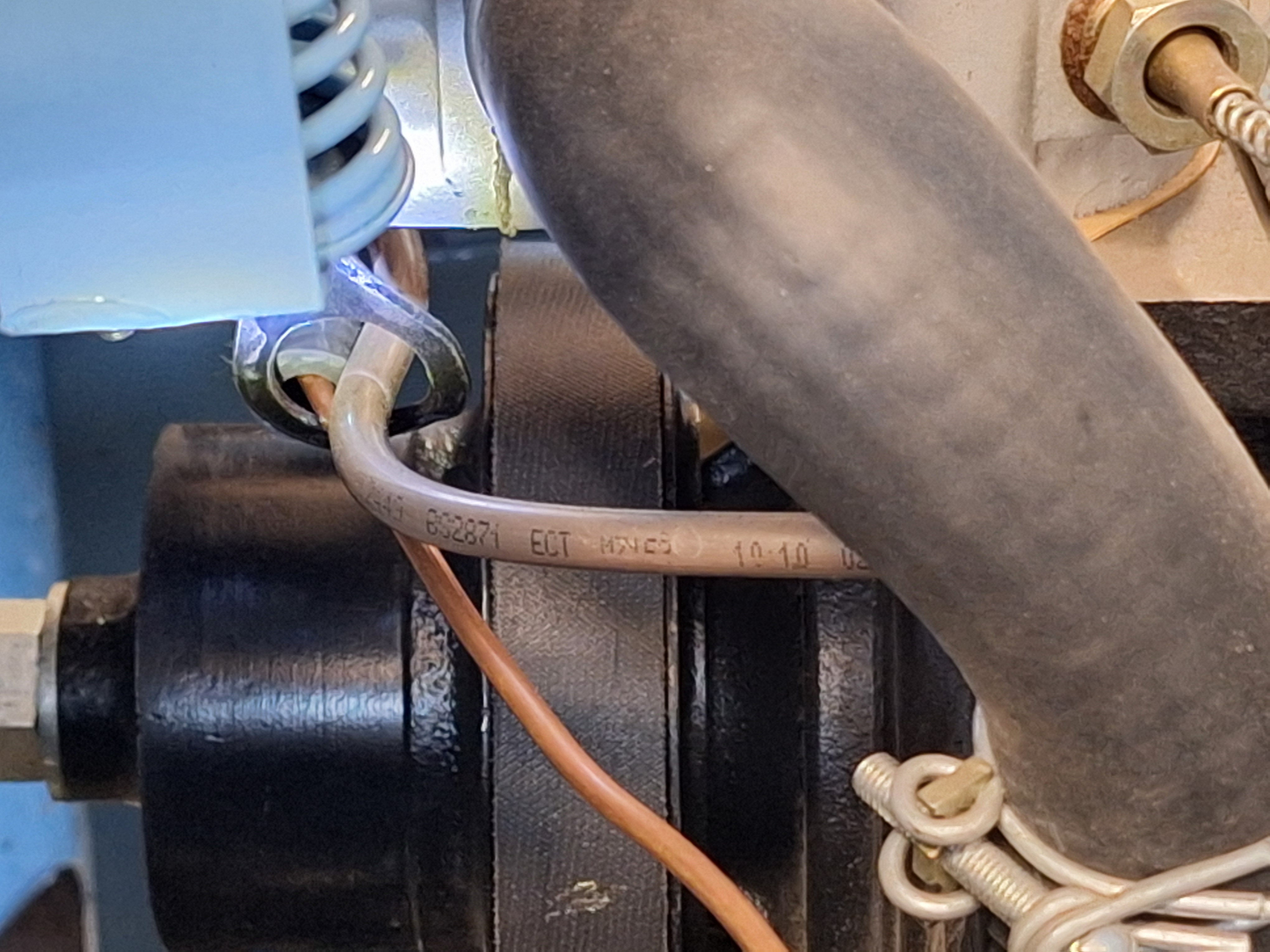

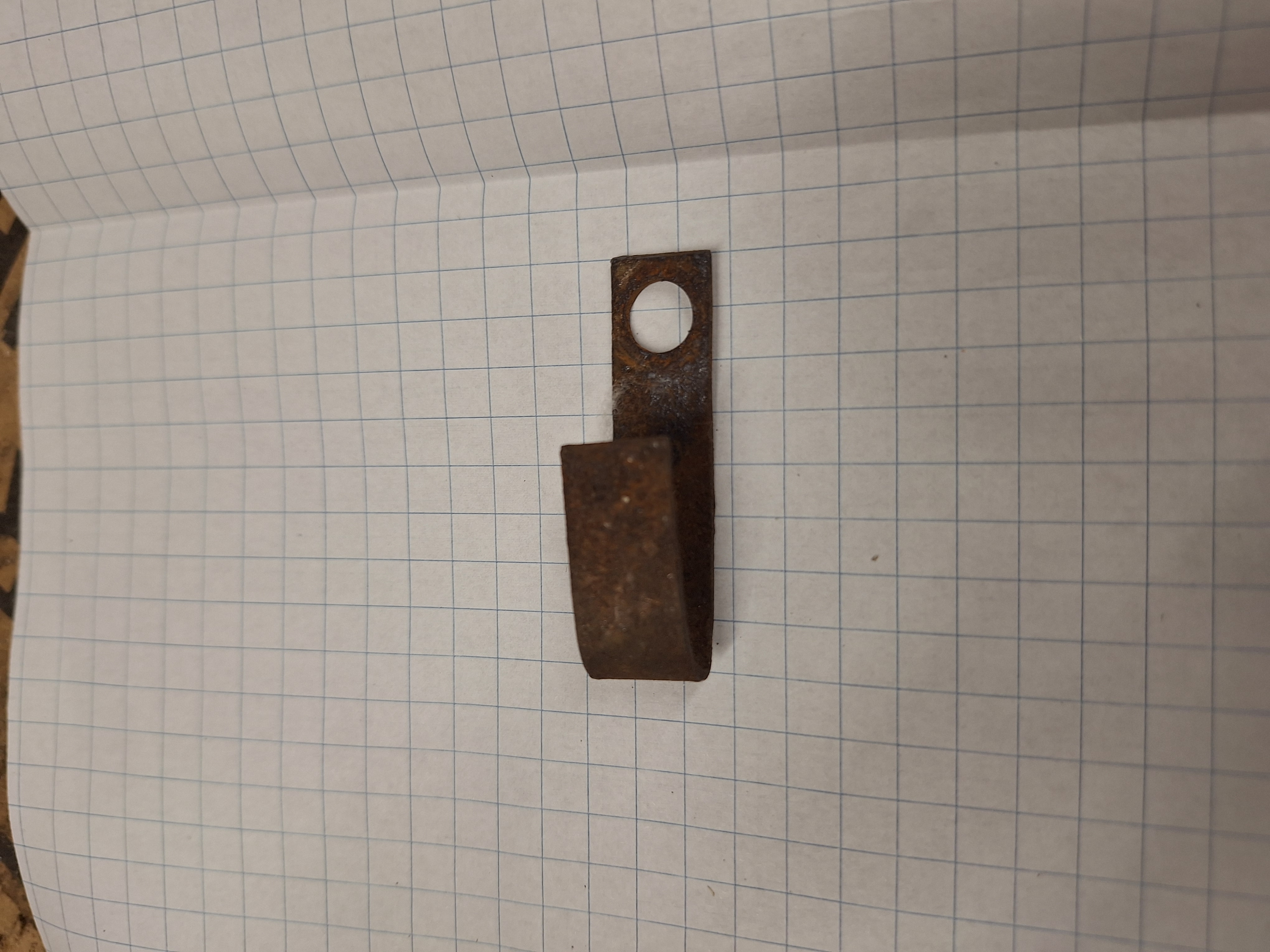

There are at least 2 different clips that I have seen on TR3&4s. Both of them run the fuel line and the vacuum line under the thermostat housing.
Attached pics are of an original clip shown on 1/4" graph paper, in case you want to make your own.
Then the same type clip with the rubber insert for the 2 lines ( on a TR4).
And the second type which is on a TR3A is best described as a hanger that has a full circle ( about 1" in diameter) that the 2 pipes fit through.
The first type with the insert is the best type. But they both function to keep the 2 lines away from the fan belt and moving parts.
Charley
