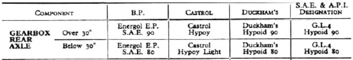

The manual for your car calls for "GL4 Hypoid" gear oil, either 80 or 90, not 50 weight motor oil. You're looking at an earlier manual.
And mixing motor oil with gear oil is more likely to produce compatibility problems. There are a lot of differences in the additive packages, and they may negate each other. If you don't know for sure what is in there, it's much safer to drain and refill.

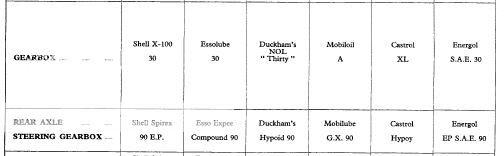

Just for my own clarification, my original shop manual (part number 502602) specifies 30 weight for UK and either 30 or 50 weight for overseas depending on temperature. Did the specification change on later cars to gear oil? I've just changed fluid in my 56 and used 30 weight non-detergent oil (same as I use in my TR6). Is this not a suitable lubricant for the transmission?
Cheers, Mike

Yes. The chart above was extracted from the 1959-onwards TR3A/B owner's manual, P/N 501528, 6th edition.
<div class="ubbcode-block"><div class="ubbcode-header">Quote:] I've just changed fluid in my 56 and used 30 weight non-detergent oil (same as I use in my TR6). Is this not a suitable lubricant for the transmission? [/QUOTE]
That has been a hotly debated topic for many years. But the factory recommendation clearly changed to gear oil, and stayed that way through the end of TR6 production (and TR7/8 I believe).
The legend as I heard it is that the factory was having problems with too many thrust washer failures under warranty, and felt that the "hypoid" (aka extreme pressure, aka EP) gear oil would help protect them. Since the thrust washers are a known weak spot in the TR2-6 gearboxes, that makes sense to me.
