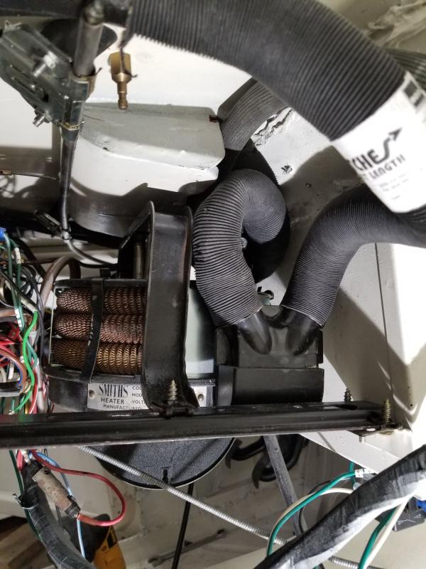

On the heater I got a new core which is shorter than the original smiths one so you have a little more room to work in there and it does put out good heat.
David
I’ve been able to get at those wing nuts with everything in place around dash. You might find it easier to work in there if you remove one or both seats. Cheers, Mike
When I take a heater out, I leave the driver side brace in so brace holds all the weight on the left. Then take special notice of temp gauge lead and gently pull it out of the way with some very flexible wire tie, then take the right dash brace out. Remove the choke and glove box and then get the heater brace nut off from inside the engine compartment. Drop the heater to the right side and unhook the hoses and you should have it.

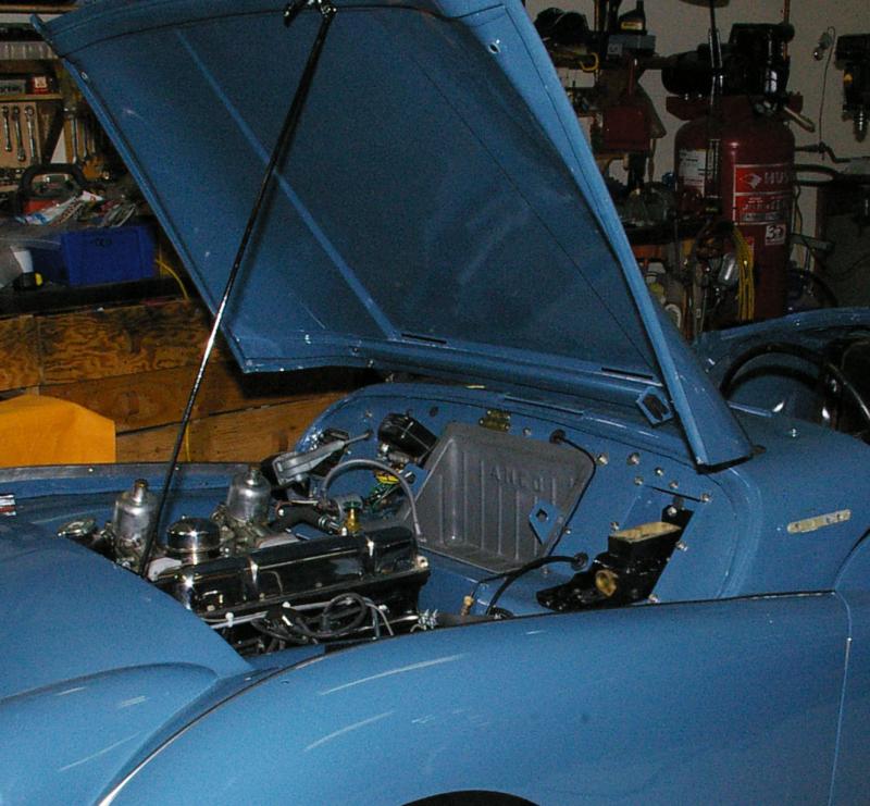

Hey Mike is your blue tr3 a 1956? If so, does your hood have the fold in the back and how many vents in the hood?
Thanks steve
Steve it has two vents ... here is a picture that might show what you want to know. Cheers, Mike
Thanks nice car, I cannot really see from the pics; it looks like the back of the hood does not have a fold at the rear edge.
Thanks. Not sure what the fold at the rear edge means. Car is in storage and not really accessible. There is a fold over of the metal along the back edge of 1/4 to 3/8 inch is that what you mean? Now you have raised my curiosity. Cheers, Mike
