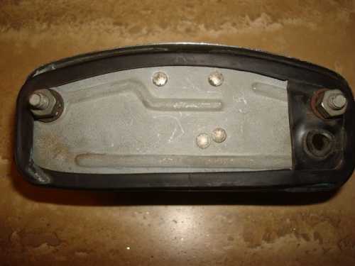

I thought I had the correct Lucas license plate light until I went to trial fit it today.
My steel lamp base has one channel gasket wrapped around edges,and looks to seal the glass and frame to body.
Problem is my rear valance has two about 1/2 holes,while lamp
base has two 8/32 studs,and a grommet for the wire,which also needs a hole for clearance.
The centers for the large holes in valance and the lamp base screws are also slightly off.
Any thoughts appreciated,
Thanks

Thanks Herman,my lamp appears to be original lucas single bulb,and yes the studs are slightly wider than hole centers,but would fit since the body holes are 1/2+,but I would need fender washers inide trunk and need a notch in passenger side body hole for wire grommet.

FWIW -- My body guy thoughtfully wleded up those pesky holes so I ahd to redrill them. Mine is a pre-60K TR3A so I took these measurements from another pre-60K car:

Thanks Geo,your pic made me realize that the two small holes were filled,and an extra large hole on pass. side.
My lamp is actually fine,although my gasket is a little different than Kieths.
