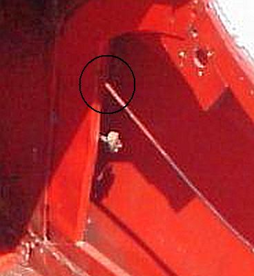

Geez, that's something I never paid much attention to, but here's a (tantalizingly fuzzy) shot of the area:
Is there a hole in the lip of the opening that the cable goes thru with a stop on the other side? Maybe the pic will at least give you an idea where to look.
That's the way mine was. Just a hole in the lip, and a ball cast onto the end of the cable. To remove the cable, you had to slide the outer sheath off and then feed the inner cable through the hole.
OK, guys. At this point I'm referring to the part of the cable opposite of the door handle, toward the front of the door/car. It is there that it should anchor in a hole in the door?
Yes, that's right. Geo's photo is of an earlier 3A which had slightly different door construction (more wood); but the late 3A that I parted out had the same arrangement (and the same doors as your 3B).
