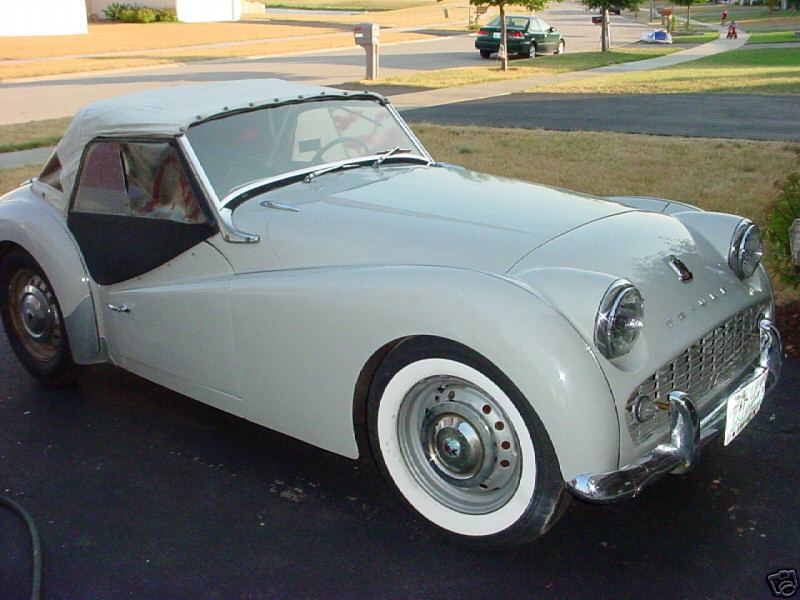

The story of my “restoration project” is kind of funny. I had finally convinced “She Who Must Be Obeyed” that buying/restoring/owning an old car would be a fun and fulfilling thing for the family to do. I did some in depth research and rediscovered my love for the Triumph TR3 and started my quest to purchase one. My idea was to either buy a roadworthy daily driver type, or one needing some minor “freshening up”. My goal was to have a nice car to just drive to local events and have some fun on the sunny weekends. I had found two local TR3s for sale … but with each one, as I drove up with blank check in hand, their new owners were driving off into the sunset. A co-worker suggested I try to find what I was looking for on E-bay …… however I was an E-bay virgin and had no idea how the whole thing worked. After talking to some E-bay experts about bidding strategies, automatic bids, and people jumping in at the last second etc., I decided that I would “practice” using some vehicles I would have absolutely no chance on Gods green earth of winning, so that when that local TR came up for bid, I would win it.
The first TR3 that caught my eye was this sharp looking grey 59 that was up in Chicago …… sooooooo ….. knowing (from the pictures and description) that it was probably worth around 10 to 12K I submitted an automatic bid of 5K secure in the knowledge that even if I were not outbid, the owner would surely have a reserve bid at least a few thousand above my bid. My first two E-bay lessons were ….. 1. I guess for some reason people don’t like grey TR3s too much. And lesson 2. You can actually sell things on E-bay without setting a reserve.
Needless to say the next step in my restoration process was to figure out how to ship a car from Chicago to Florida. As it turns out, the gentleman was moving to Texas, and his wife refused to move a “project” that had been started in late 1975, and hasn’t been worked on since early 1976 ….. (a little unreasonable on her part … but what the heck). The big “catch” was that he had drug his feet in selling the car (thinking he could convince the wife to take it) and was leaving for his new house in Texas in a week …. Lesson 3 …. If an automobile company only has a week to pick up a car, they charge you BIG TIME.
I was very lucky …. The P.O. was very honest in his description of the car, so there have been very VERY few bad surprises, and those that I’ve come across I am convinced the P.O. would or could not have known about. And a number of pleasant surprises …. For instance, the car has not even been turned over since 1975 …. I threw in a new battery …. And the engine spins freely. There is minor rust thru in the trunk area by the wheel wells, and minor rust thru on the floorboard passenger side near the firewall, not enough in either case to warrant buying a new panel and will be repaired by welding in some sheet metal scraps fabricated to fit. The body is drop dead beautiful (for a car this old) some minor dings and scratches but nothing major. As far as rust, there is one spot of surface rust about the size of a quarter below and behind the driver side door. I have honestly seen worse rust on a three to five year old cars. The interior was a mess and has to be completely replaced; all the parts are there but everything needs recovering …. but like I said the PO was perfectly honest about the details.
Most of my expenditures so far have been for rebuild kits for breaks, master and slave cylinders, carbs. I’ve also purchased a kit to recover the seats, and am replacing all of the rubber components (hoses, belts, etc).
