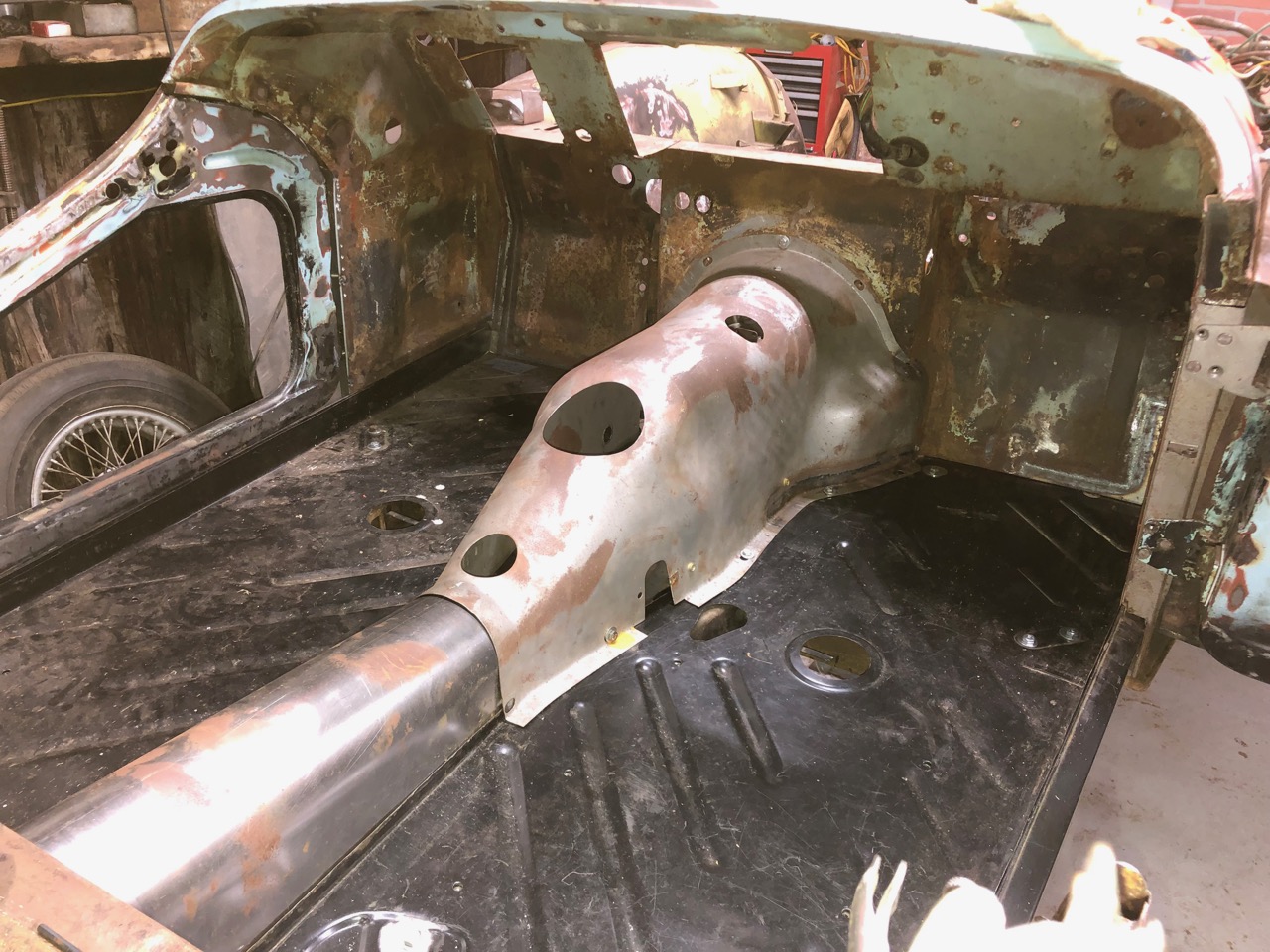

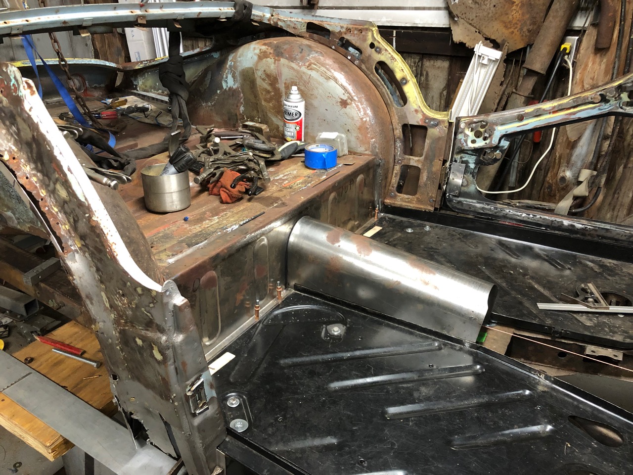

Transmission cover Fits and lines up well. All of the alignment is based on a string running down the center of the car.

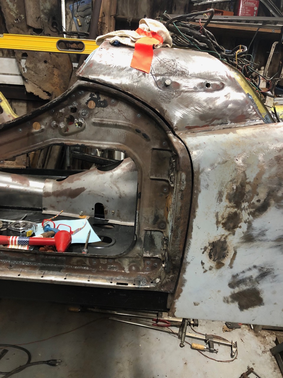

Not much time to spend out in the shop tonight but just a few minutes with the hammer and dollie and found that the door frame is pretty easy to adjust. Scuttle to door frame gap now pretty consistent 1/4" so it was pretty easy to close that gap by an 1/8". I believe the door frame to fender gap will also be easy to get it a little wider. I believe I am going to go ahead and tackle getting the passenger B post adjusted where it needs to be before any more work on door frames. I feel a little better about this now. Frank

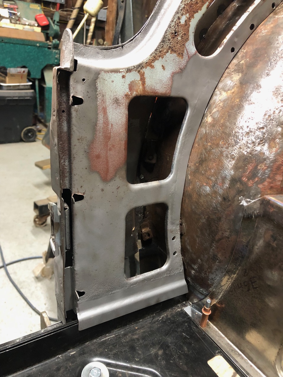

The B post needs a little adjustment as the top needs to go in at the top about 1/4". I think the 1/8" gap where it fits to the inner sill will take care of the adjustment. The bottom of the B post is correct.

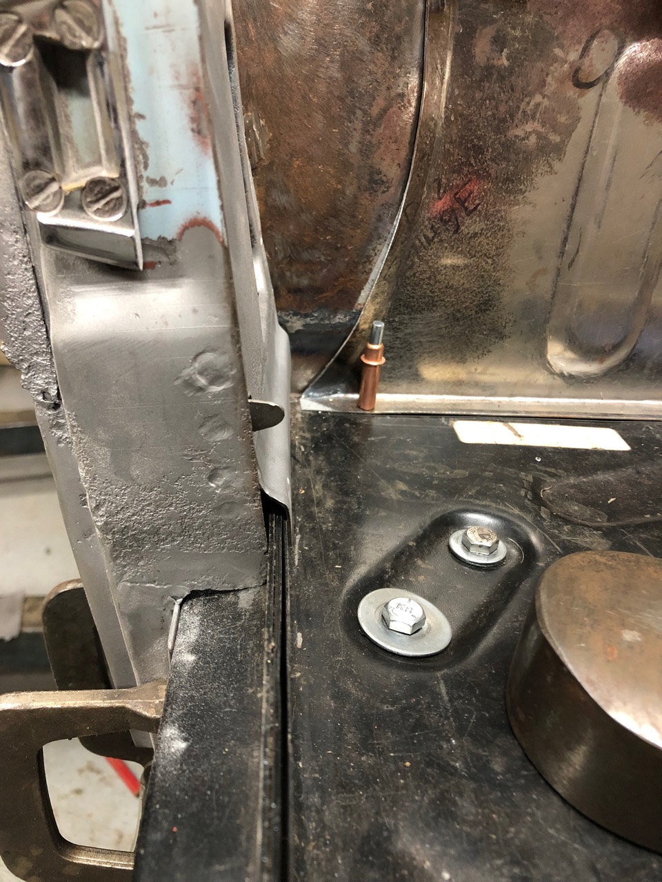

The back side of the B post gets the same cut. Clamped back on the car to check alignment, tack the flanges, unclamp the B post weld up the seams, reclamp it on the car. Alignment is very good, measurements from centerline now match the driver side as well as angle measurements match the driver side so feel like the B post is good now.
Now the passenger side B post fits the inner sill and the alignment seems good. The flange that fits over the floor pan flange was cut off so still have that to replace. So far pretty happy with how it is coming together. Frank

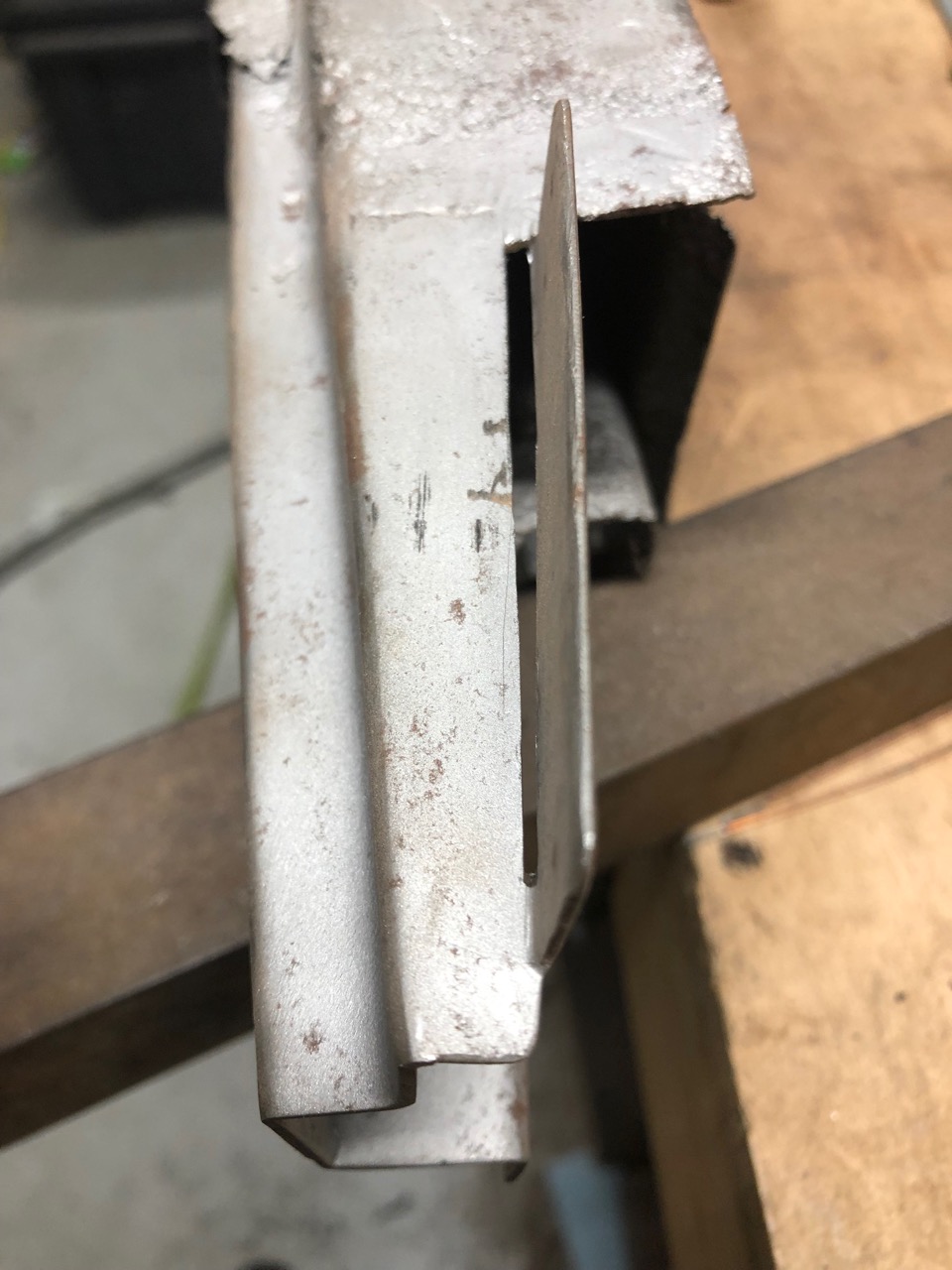

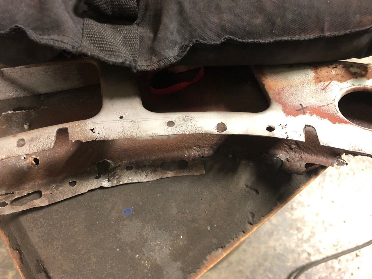

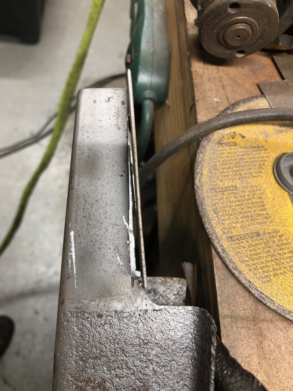

I ended up doing a little more repair work to the B post.

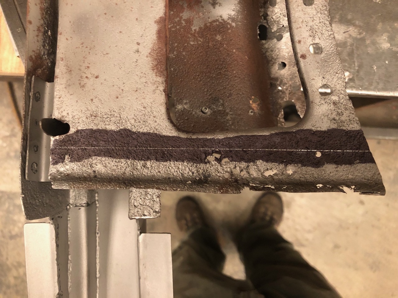

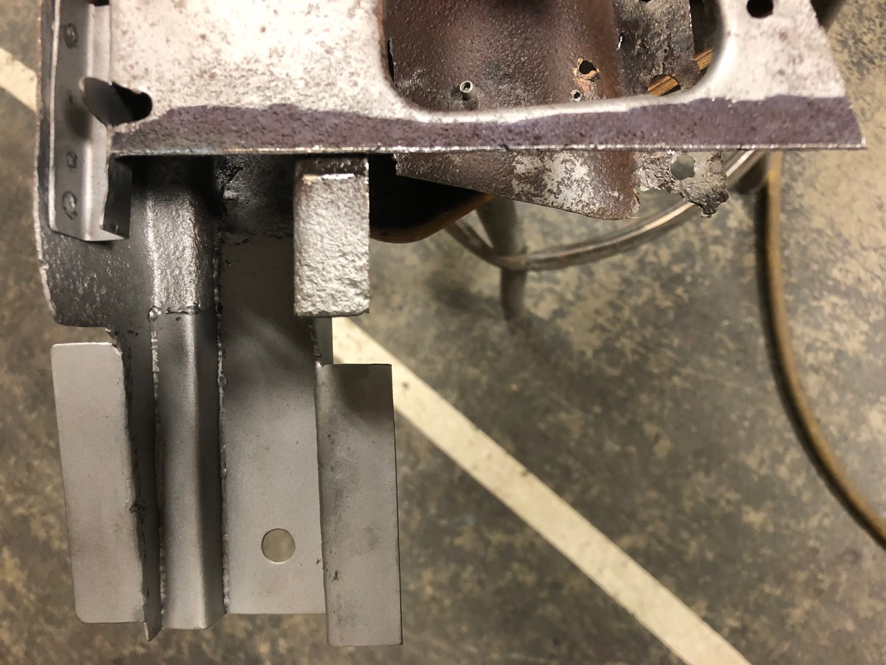

The doner B post was cout where it meets the floor pan and they cut the flange off. The scribe line is where the repair will be added. I missed taking a picture of the repair Z shaped flange that I ended up hammer forming as it is a difficult piece to form other wise. I guess you could do it with a brake but the radius of the bends is difficult to match and you would have to take the apron off to get that tight a bends back to back.
Notice I did not cut on the scribe line. the repair piece was laying on the damaged flange when I scribed the line so I have allowed the thickness of the metal off the scribe line so the repair flange will line up where the original one did.
Repaired flange welded and finished.

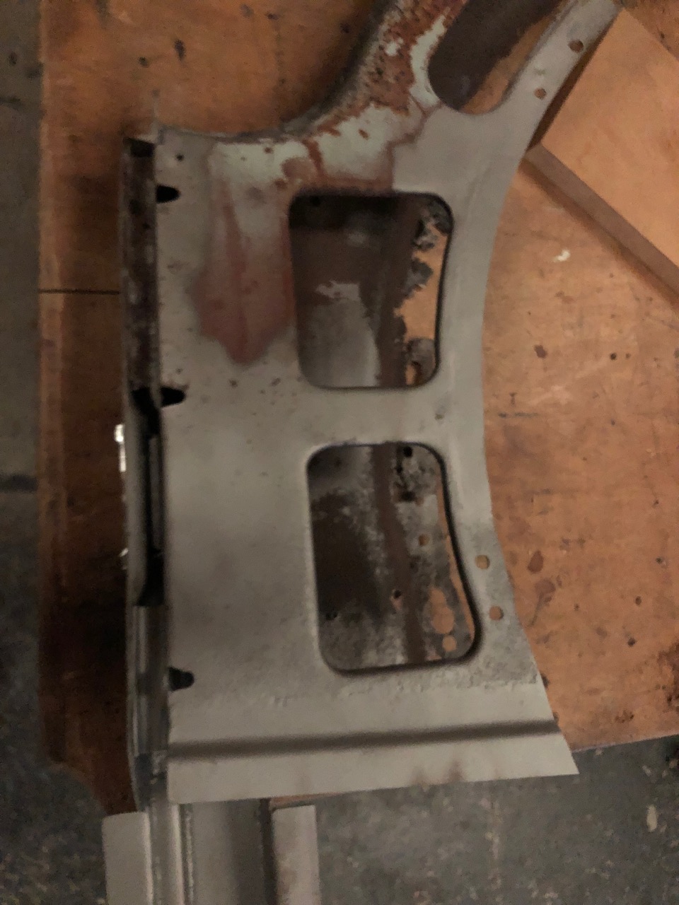

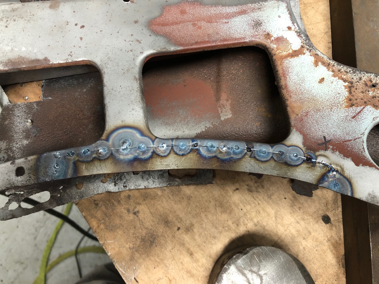

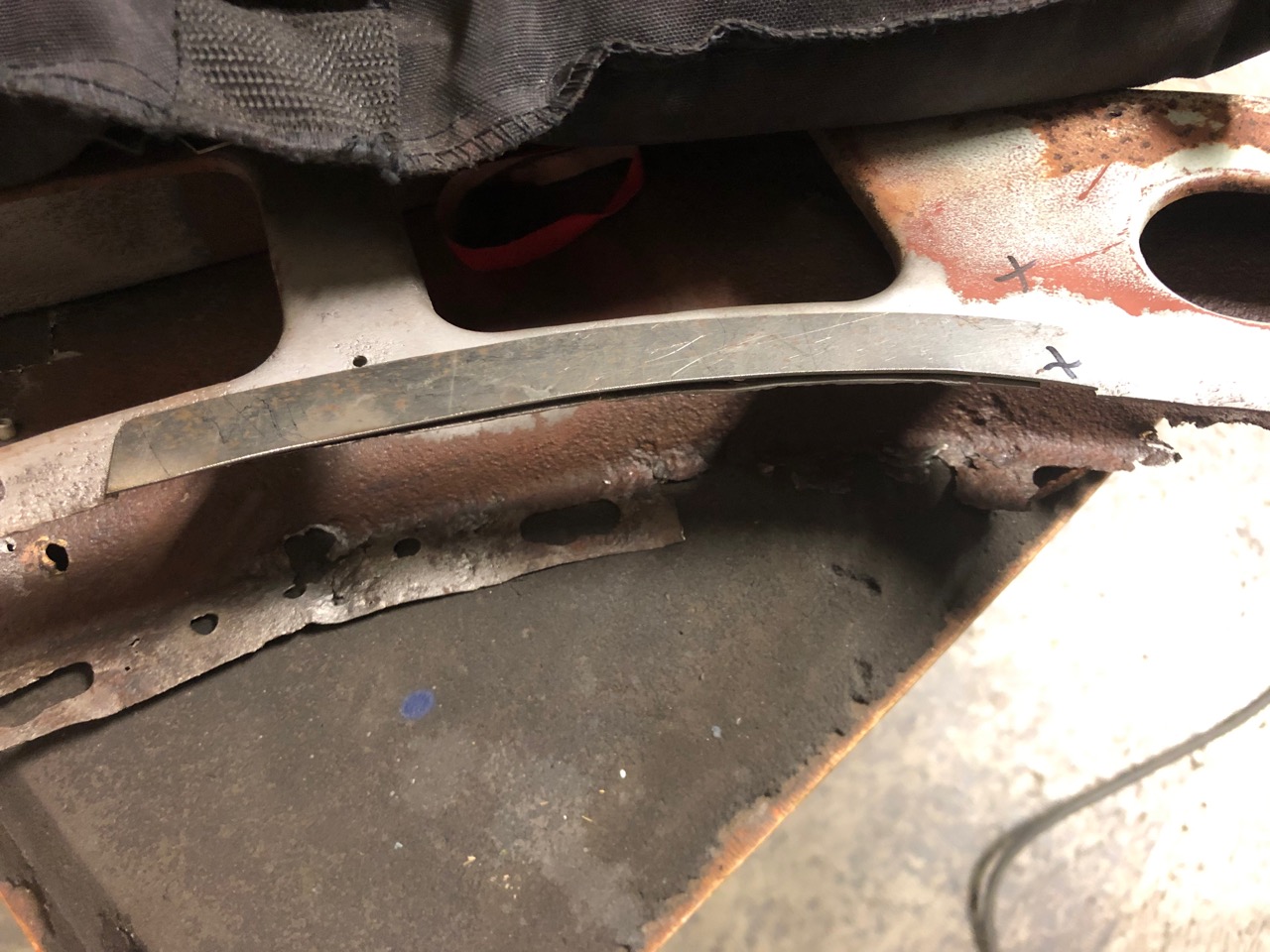

The inner support had 3 areas that were like lace and it probably would have been fine but like the weld joints that would not have been seen in Chef Tushes video, this just bugged me and so went ahead and fixed it.
Here is the patch. it would have been easier to cut a strip and shrink it to form the curve but this is the better way. No stress on the repair.

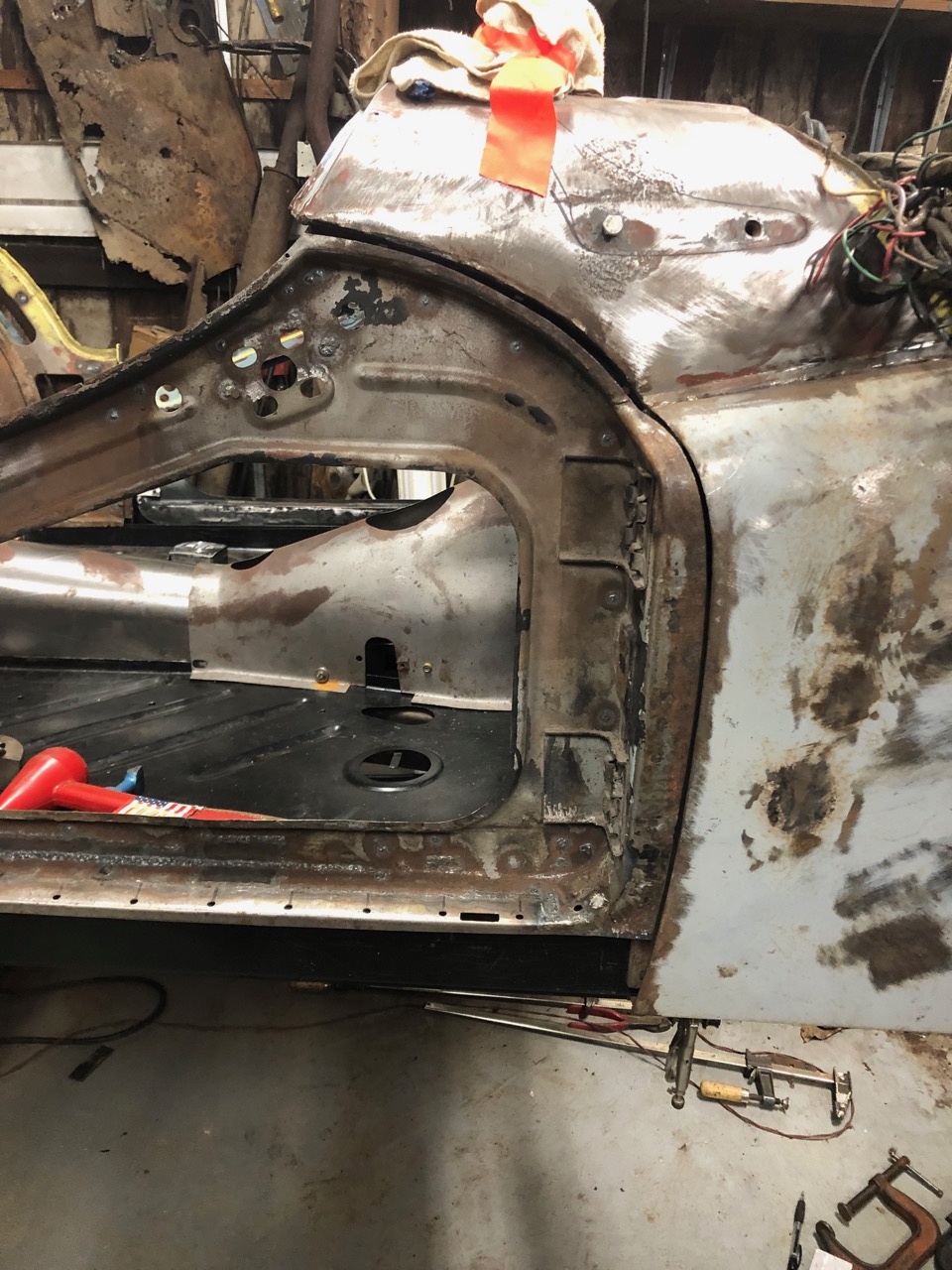

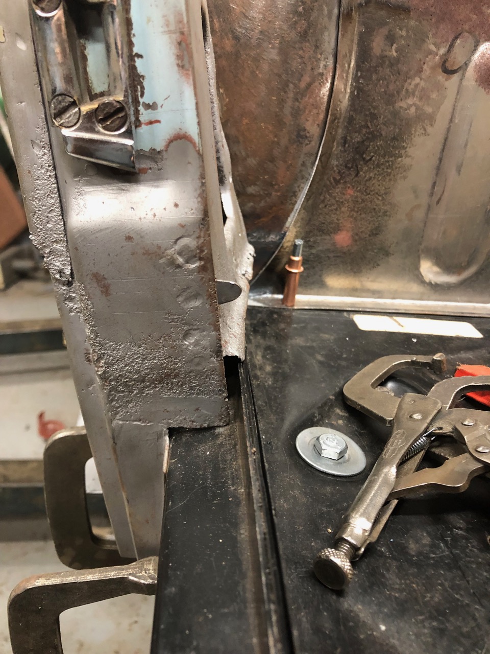

B post back in place. The flange holds the floor pan.

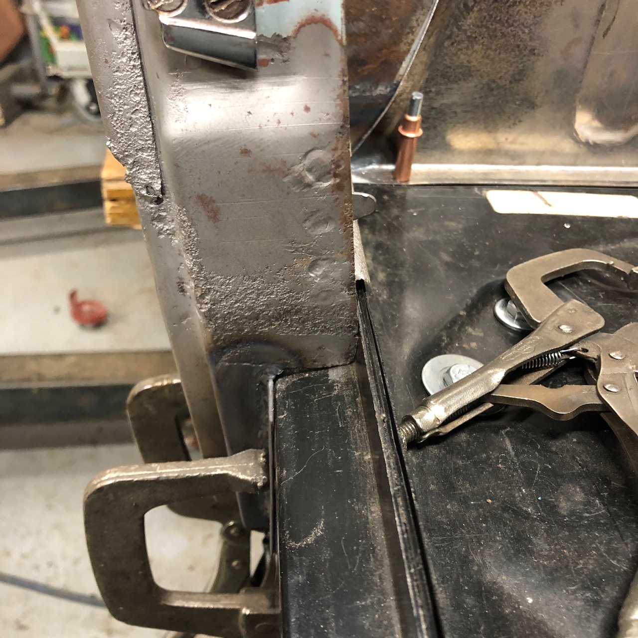

End view of the B post with repaired flange. The B post has been on and off several times and I make minor adjustments as I go. At this point I feel it fits really good and is time to weld it to the back half.

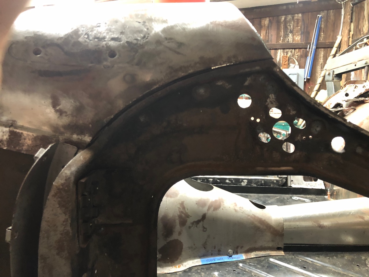

A little more work on the door frame. Looking better. I will need to shrink the curved area in the middle of the door just above the upper hinge as it sticks out too much. I will give that a try and see if it helps or not. Still trying to get a feel for how all the pieces work together before I start tacking. I still have the driver side scuttle to repair where it arches over the door. Frank
