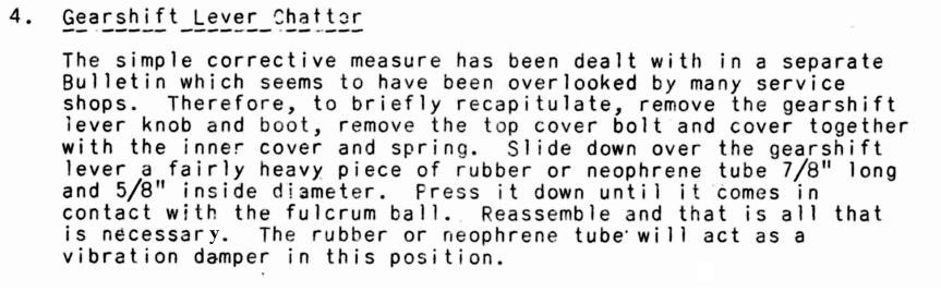

<span style="font-size: 11pt"><span style="color: #003300">My copy of the Moss catalogue says in the "fine print" that 031-652 is for TR3Bs and TR4s; No reference to the TR2-3-3A.
As for the rattle, a dealer service bulletin had a solution that I tried 20 years ago & has never been an issue since.
# 4 on the photo. I'm sorry, I'm not that good at posting photos !! </span></span>
Ok if I try?
