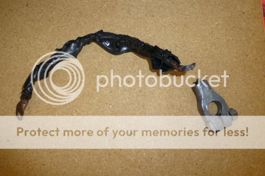

I was changing the starter a couple of weeks ago and wrenched a but too much on that nut - cutting through the fiber washer. Did you know that battery cables can now be had in 'original' or 'extra crispy'?
