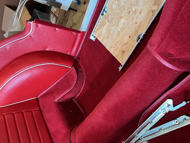

I planned to install the driver seat in my 59 TR3A today and it didn't go as planned.

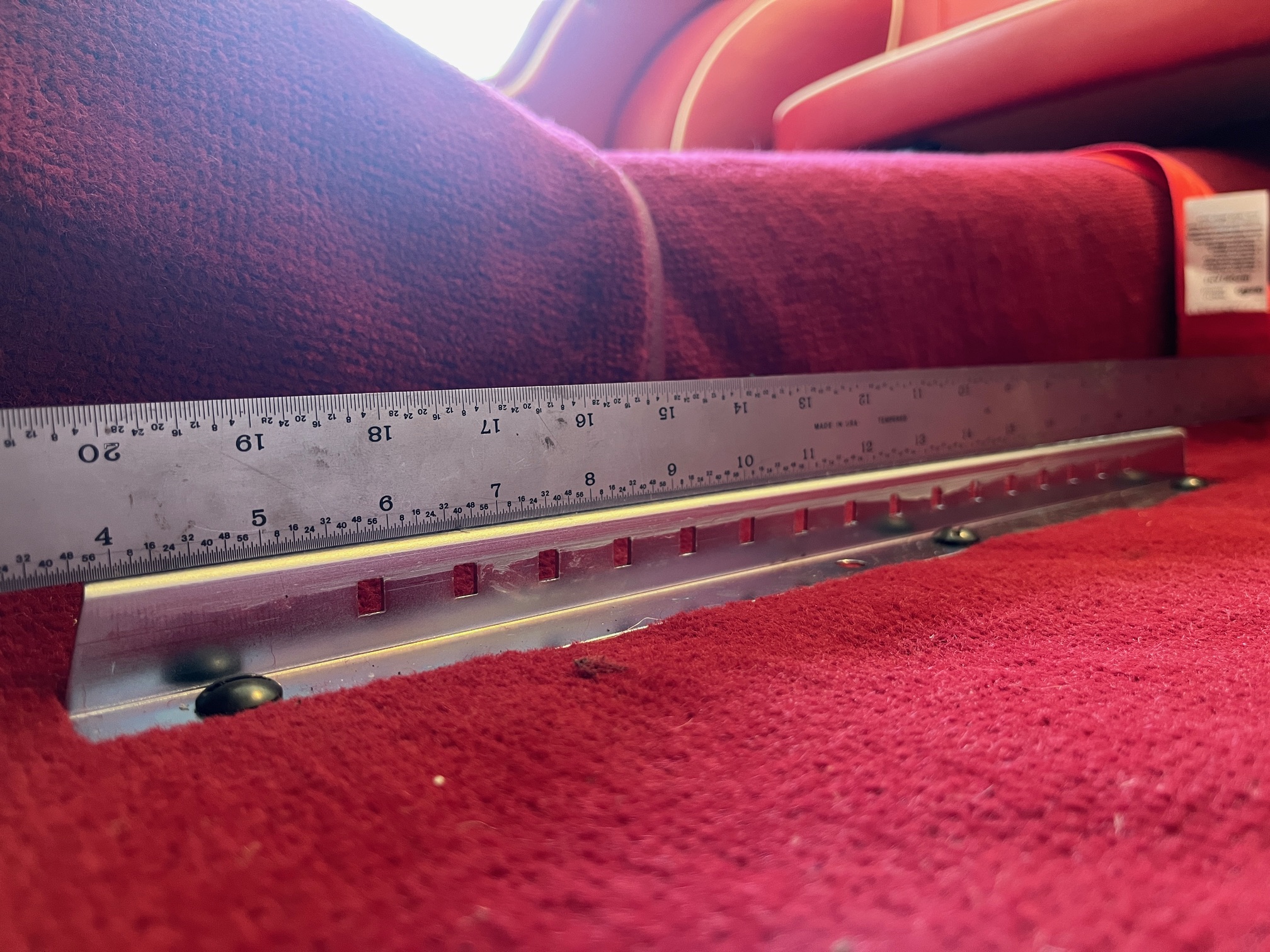

I installed the new Moss floor tracks over the carpet and used a piece of plywood ripped to 12" to maintain the spacing between the floor rails while I tightened the screws. I checked the seat rail fit on the tracks to make sure I didn't warp the tracks when tightening the screws to the floor and they slid back and forth easily.
When I positioned the seat rails on the floor tracks and positioned the seat on top, I noticed the posts didn't match up with the holes in the seat pan. I expected this since I heard that replacement floor pans have the cage nuts in the wrong position. I elongated the holes in the seat pan to fit the seat rails, put a light coat of lithium grease on the tracks, placed the seat on the rails and tightened the 1/4-28 nuts. After doing this, the seat was locked in solid and wouldn't move. I've disassembled and reassembled multiple times and can't figure out what is causing the binding.

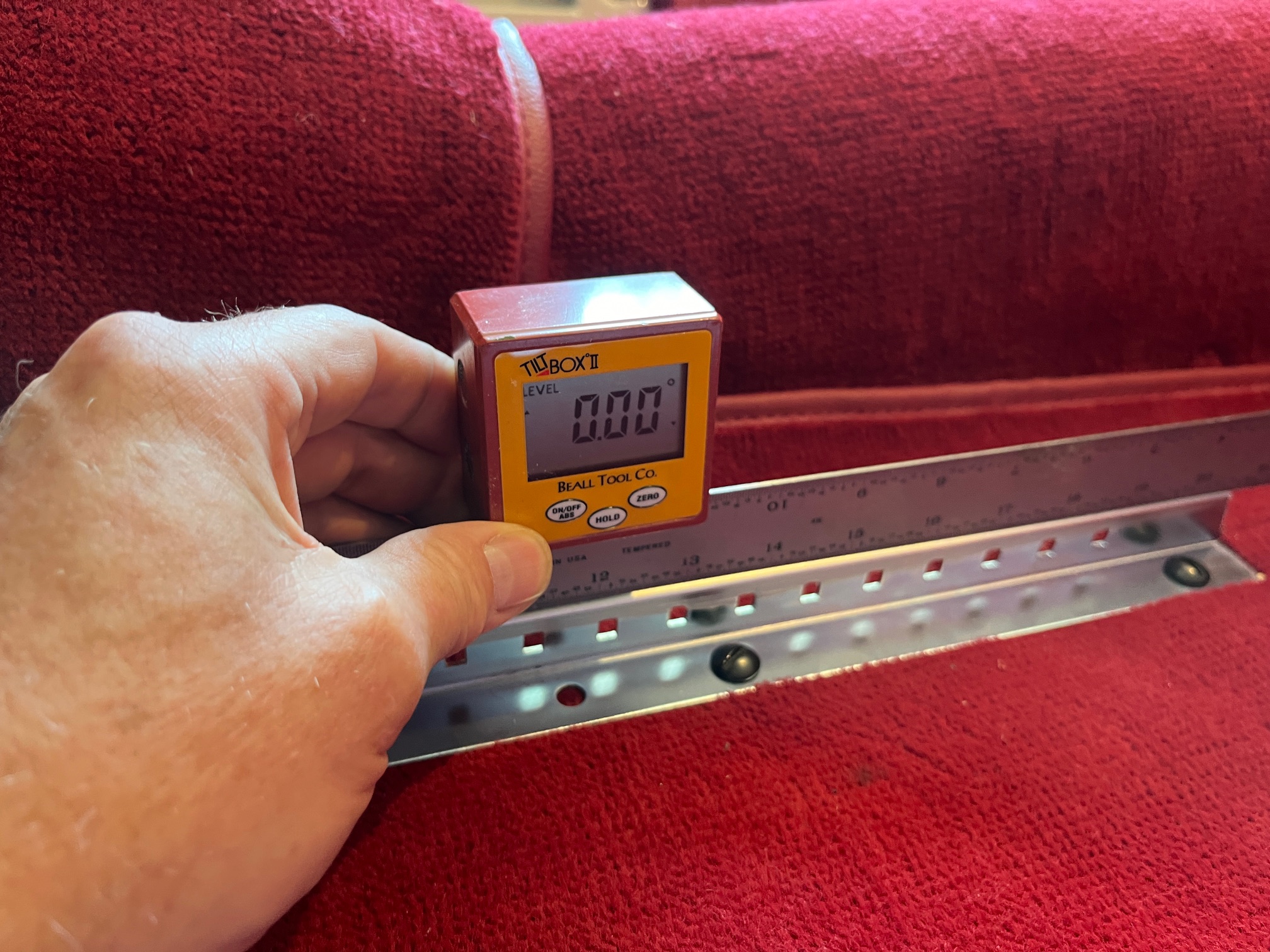

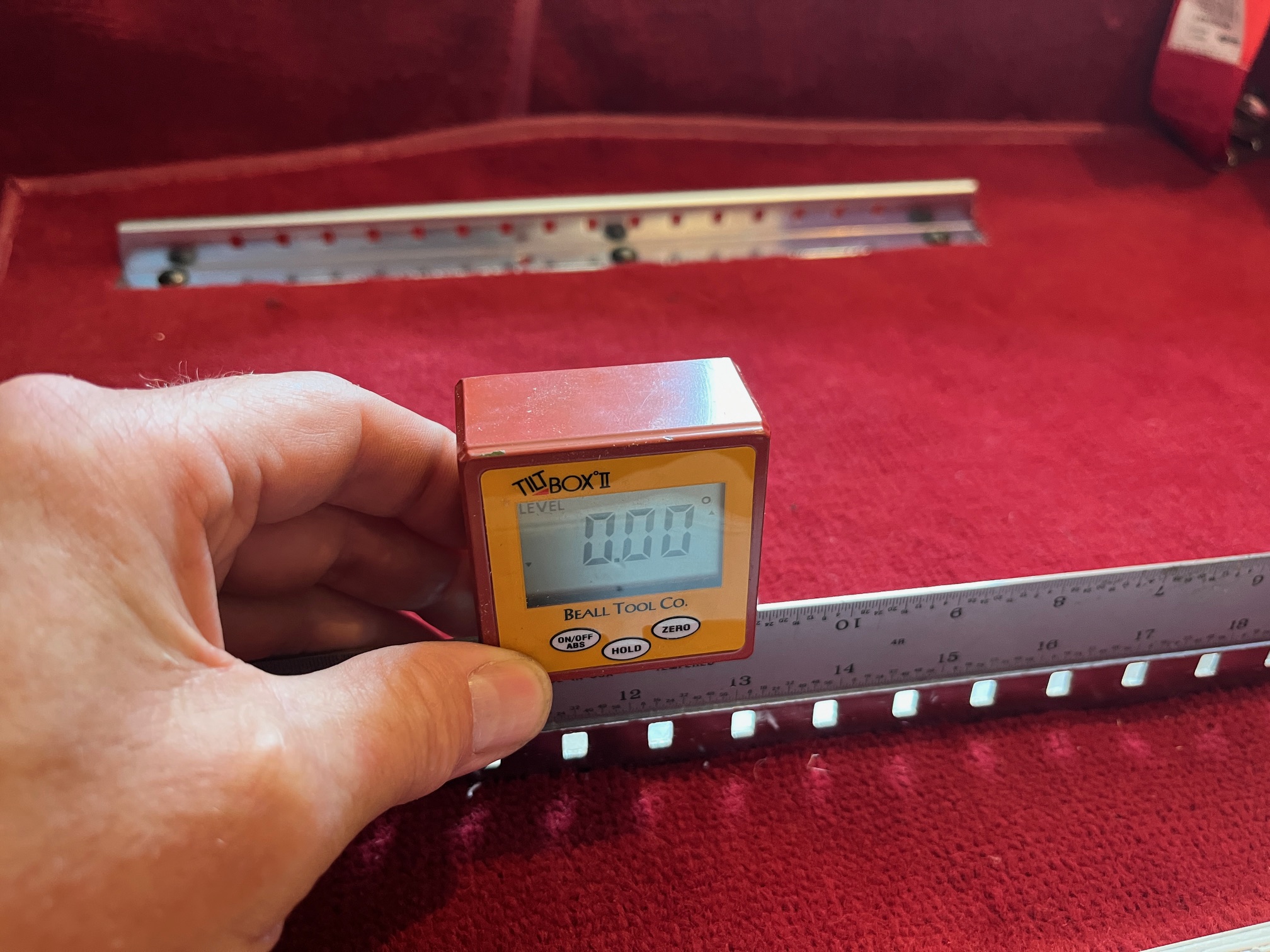

I checked the floor tracks and they were flat as a pancake and completely parallel to each other due to the plywood board I used to set the spacing. Since I used 1/4" heavy washers to space the tracks and minimize carpet caused bending, I didn't expect any but nonetheless I used a digital angle gauge and a straight edge to see if there was a difference in front to back angle between the two tracks. Both tracks read zero degrees so there isn't any angular difference between the two that would cause binding. At the same time I looked for a gap between the track and the straight edge and didn't observe any.

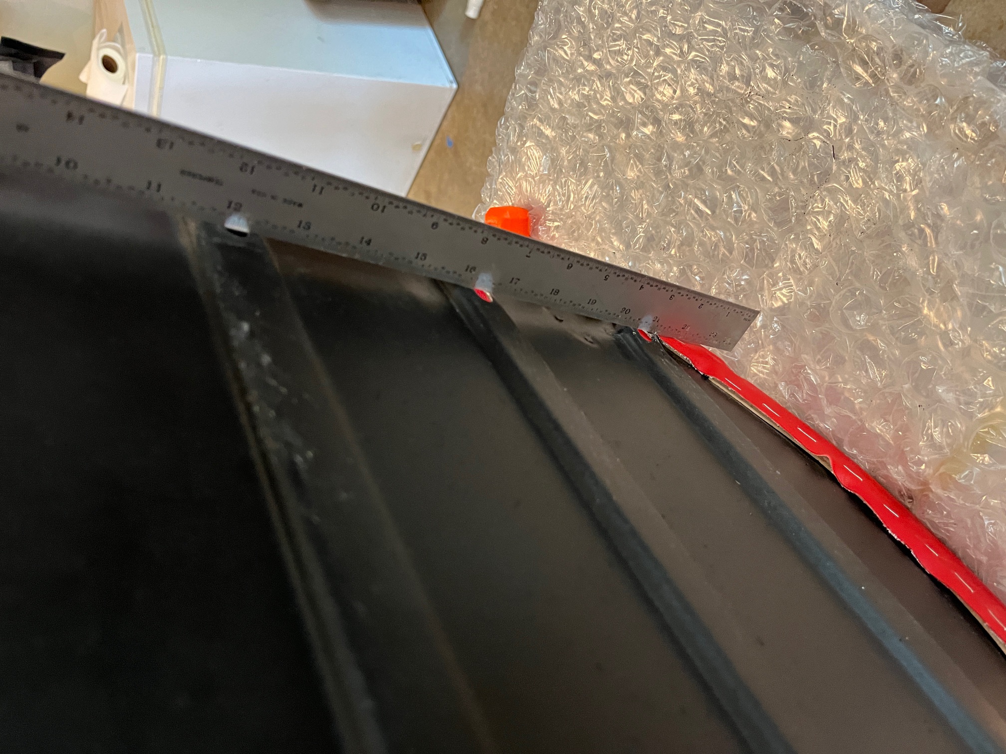

I then looked at the seat bottoms. I put a straight edge spanning the holes and discovered one hole location was lifting the straight edge by over a 1/16” and another had almost an 1/8” gap. Hmm, this could be a problem.... so using a hammer and aluminum plate I beat the ribs on one side or another until the straight edge was flat spanning the holes as shown in the image.

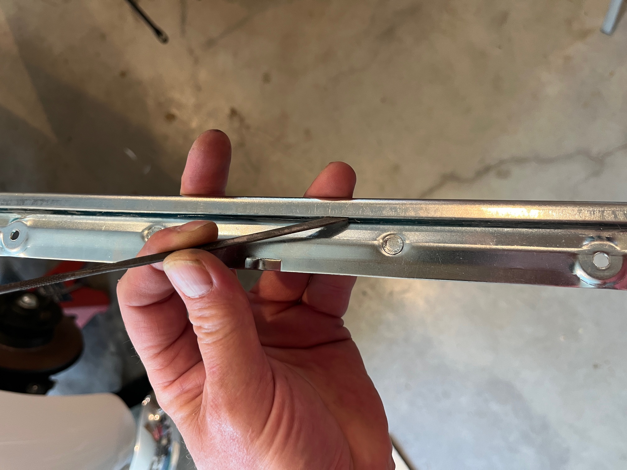

Before I reassembled everything, I draw-filed a radius on each of the mating edges of the rails and floor tracks, taking care to remove the shear burr that was on the mating sides of the track an rails. I had to use a needle file on the inside edge of the rails that mount to the seat bottom to remove that burr since a standard file was too thick. The radiused edges were then sanded with a few passes using 220 grit emery paper. All the mating surfaces were brushed with a light coating of lithium grease before reassembling everything.

I'm guessing the difference in the plane of the holes on the bottom of the seat, despite the tinfoil flexibility of the seat bottom, caused the seat mounted rails to warp when the nuts were tightened. On to the right seat to see if I can replicate the fix...
