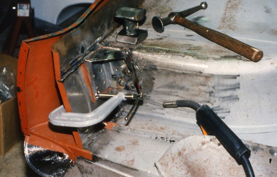

The bottom 4" to 5" of the rear end on my 1958 TR3A was like lace when I decided to replace the rear valance in 1988. I bought the full valance from Cox & Buckles in Richmond-on-Thames and had it air shipped here. It was then that I found out about the differences in the stampings between the "early" TR3As and the "later" TR3As. The stamping I received was for the later TRs while mine is an "early" one. Also the domes for the directional flasher lighs on the repro rear valances are much "shallower". So I cut it half-way-up the spare wheel cut-out and the rear tail on my TR half-way-down and MIG welded it into place. I used butt welds so it would be smooth inside and out with no overlaps.
Tush - If your TR3A is a later one, it will probably fit but in my case, all the troughs for the trunk lid seal were different.
No one can see where I did this and after about 20 years, a chap in Kingston Ontario left his TR3A on the slope of his driveway while he got out to close his garage door. The un-guided TR rolled down the slope and backed into a garbage truck which just happened to be passing. So I sold him the left-over top half of my rear valance for what I had paid for it so he could repair his TR.
In this photo from 1988, only the bottom 5" or 6" is from the new repro valance.
