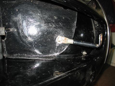

Here is mine which has been in my 1958 TR3A since 1990. The only attachment I use is behind the flange for the upper angled tubular supports which secure the top of the front bumperettes.

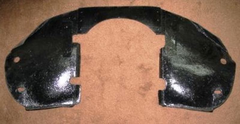

Ignore the 4 rectangular notches which I made to clear the brackets for my front electric pusher fan. It comes as three pieces. One for each side and one that goes across the top of the radiator. They are held together with 4 (or are there 6 ?) brass tab holders like you might use to keep pages together like for a three-leaf binder. There are two (or three) at the top right and two (or three) at the top left which hold it all together. The air deflector must be sprayed the same colour as the car.
Some people screw the lower flanges to the "deck" but they never move the way I have them without screwing them down.
Your description is how I installed mine. Bend along the scores before installing and fold the side inward and push it in through the grille opening. There should be four rivets to connect the cross piece to the two side panels. I think the four screws and washers are included to go through the flange edge on the bottom of each side, two per side. You should see punch-out holes there. I did not use them because I didn't want to drill holes in the front apron.

I'm thinking I found holes in the pan at the bottom of the apron for those 4 screws -- in any case I screwed it down there as well as having it clamped in place by the bumperette support.
