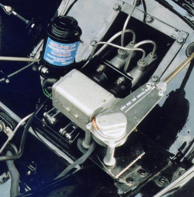

The pipe on my early 1958 TR3A goes from the outlet of my master cylinder as shown. Your master cylinder should have this exit at about a 45 degree angle whereas mine is correct (vertical) for all late TR2s, all TR3s and the early TR3As. The pipe goes over the master cylinder for the brake then down behind and under the reservoir can. It sits flat on the skuttle and hugs the curve as it bends downward to the connecter bracket welded onto the frame where the pipe joins with the braided flex hose to the slave cylinder.
Note the clip that secures the pipe to the outer-most screw for the heater hose fitting on the bulkhead.

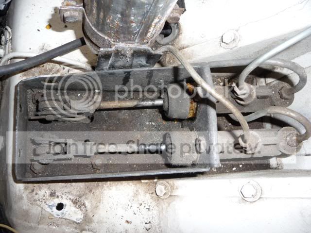

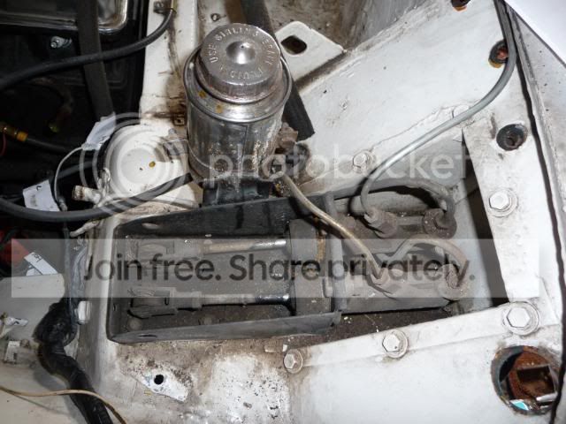

Hi Tink,
I see that Don beat me but I will post mine anyway. This is how they are installed on my car. No idea if they are correct or not.
Cheers,
M. Pied Lourd
It's the outlet to the brakes/clutch that is straight up on early models, slanted on later models. The port that gets the line to the reservoir is always straight up, early or late.
Otherwise, Don & Pied have covered it pretty thoroughly. I'll add only that TRF sells the pre-bent reservoir lines separately.
