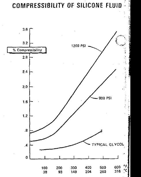

They are all fluids, and you can't compress fluids
Not true. Everything is compressible to some extent, even steel. And DOT 5 is slightly more compressible than DOT 3/4/5.1, particularly at high temperatures.

Suit yourself, Mikey. But sometimes the text books are simply wrong. Agreed, the pressures and temperatures given are extreme limits, but both do happen in "real world" driving. In fact, that chart was taken from a report on "real world" testing of production cars descending from mountain passes, and they did have failures due to both boiling and lack of travel (due to compressibility).
I haven't been to any Alpine passes yet, but there are some pretty high ones around here, and I do enjoy driving my TR hard on mountain roads. If you look close at Don's photo above, it reads "Elevation 11542 ft", and I've been there several times.
But even using your book's value of 300F, and 800 psi (which is a reasonable pressure for a panic stop with cool brakes), the chart gives a compression of 1%, which seems worth considering to me.
Check out Nelson's article, where he first predicted the extra pedal travel due to DOT 5 compressibility, and then measured it on his own car.

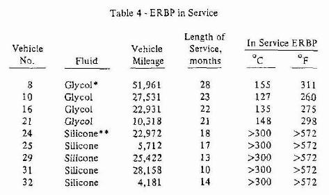

https://www.buckeyetriumphs.org/technical/Brakes/Fluid/Fluid.htm
Oh, one other point, the SAE only specifies <span style="font-weight: bold">minimum</span> boiling point under specific test conditions. That doesn't mean the fluid will always boil at exactly that temperature. Thus, for example, there are many racing fluids around that are rated DOT 4, but don't actually boil until well past 500F (when dry). The "wet" test points are also rather optimistic; G.R. Browning reported finding cars in service with water contents as high as 6.7% water in the brake fluid (and corresponding boiling point of 260F).
