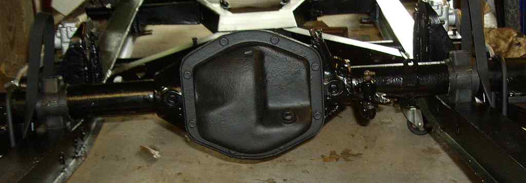

I do have a question regarding the rear axle rebound buffer. I checked all the books I have and search the web but couldn't find a proper picture or even a piece of information how to wire the buffer to the axle. I anyone could give me some advice on that it would be great. Thanks!

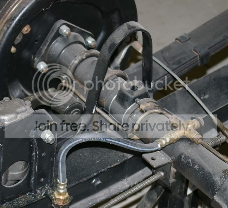

The knobby parts go up and down. I used two stainless steel tie wraps on each buffer, one on each side of the knobbly. Got mine from Harbor Freight - Item #92515.
I have the buffer already in place but I'm simply not sure how to use the wires keep everything in position. Should I make a loop around one side of the buffer and then put the loose end of the wire under the nut that holds the buffer strap?
I'm trying to sort out the way it was originally designed to work.
Welcome to the club. I'm not sure this picture is good enough, but you can see how I did mine.

They were put on with tie wirer one piece on each side of the bumper. They just twisted the wirer tight. It sound too easy, but that is how it was done. It takes some practice, but bring the wirer around by hand and give it a nice even twist when the two wires met, perhaps twice, then trim the ends so they are about an inch long. Now take some pliers and pull back and twist at the same time until you get about four uniform twists. Ask a carpenter or ironworker to show you.

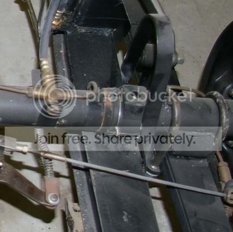

Perhaps these pictures will help. Looks like you are making great progress on your car. Cheers, Mike
Thanks for that last picture. Using 2 wires one on each side of the buffer is a solution but I still wonder what was the original way of fitting it. I've got same wires that are shown on enclosed picture and catalogues I checked state that there are only 2 required per car. But I'm considering upgrading to two wires on each side or straps as you sugested.

The originals were like hession potato sack wire ties - gripper eyelets at each end of the tie as shown in the parts drawing, that could be twisted up manually or mechanically.
Black plastic cable ties make a modern substitute.
