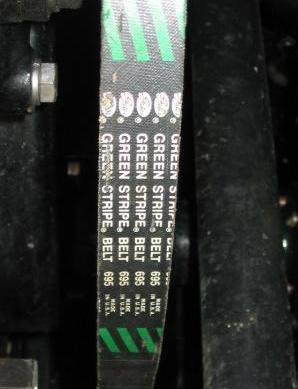

I haven't tried the latest NAPA belt, but - thanks Randall - now I know it will do some day when I need to put on my spare. Here's the one I put on in 2007 which I can carried as my spare in the "boot" from 1993 to 2007. I believe I got the info on this fan belt from Bob Shaller and Digger Davitt (bless their TR souls) back about 1994 during a business trip to Phoenix.

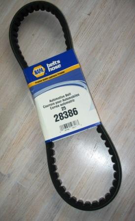

I paid $27.00 for the latest 25-28386 NAPA fan belt shown in the photo above. Even with the US to CDN dollar exchange, the rest must be for transport up here to Montreal plus profit.
