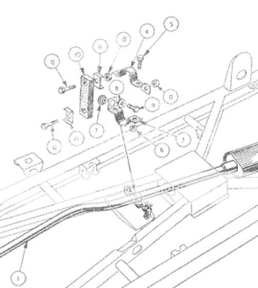

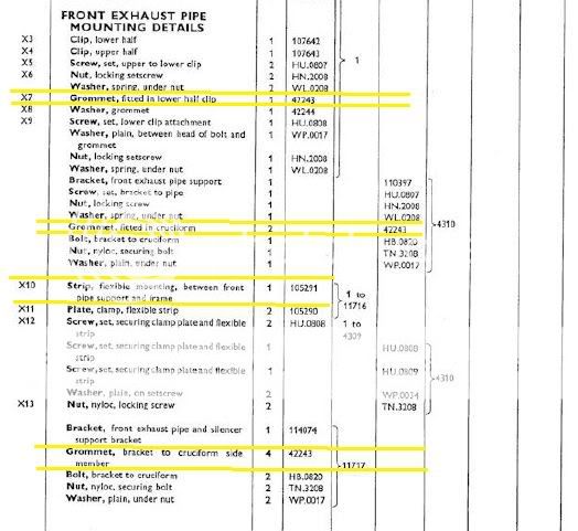

Should the exhaust bracket that holds the exhaust system under the gearbox have rubber grommets or spacers where it bolts to the frame?
I noticed such a rubber spacer in the photobucket pics that Alwallace linked yesterday in his "opinions wanted" post.
I didn't see any when I took mine apart, but I can see where it might make sense to have them.

Yup, should be nesting grommets there. But they don't hold up so well, so they are frequently missing.
Available from moss or TRF, I forget where I got mine.

You can also find these grommets as hardware store items.
Against the grain of much of the commentary above: I don't see anything wrong with the TR3 bracket you're asking about. Things are certainly congested and hard to get at in that area, but this is pretty much a standard state of affairs for TR3s. And the TR3 bracket does provide spring tension at that point, which protects a bit against some mechanical rattles which can develop around that zone.
