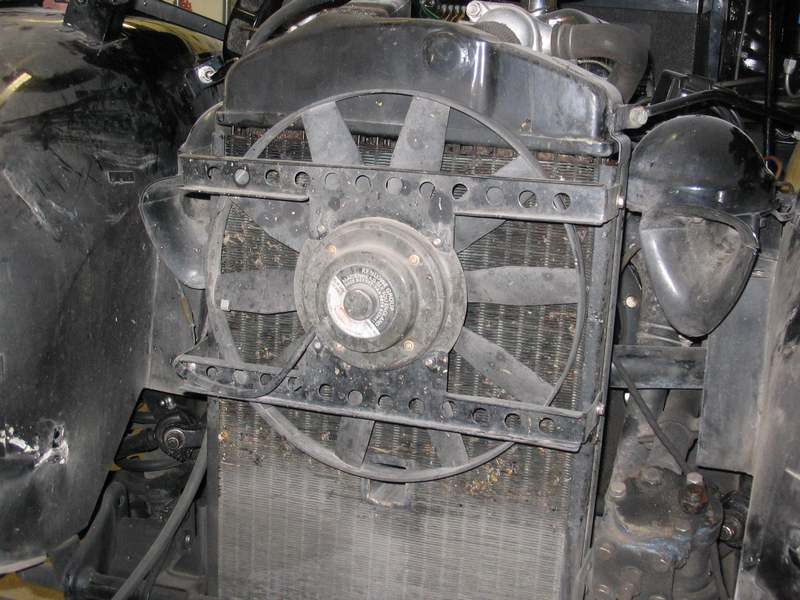

I cool my TR3A with a pusher fan I bought in England. It's a 10-blade shrouded Kenlowe fan and is located between the grille and the radiator. I assume the judges at VTR docked me the normal 2 points if the saw it.

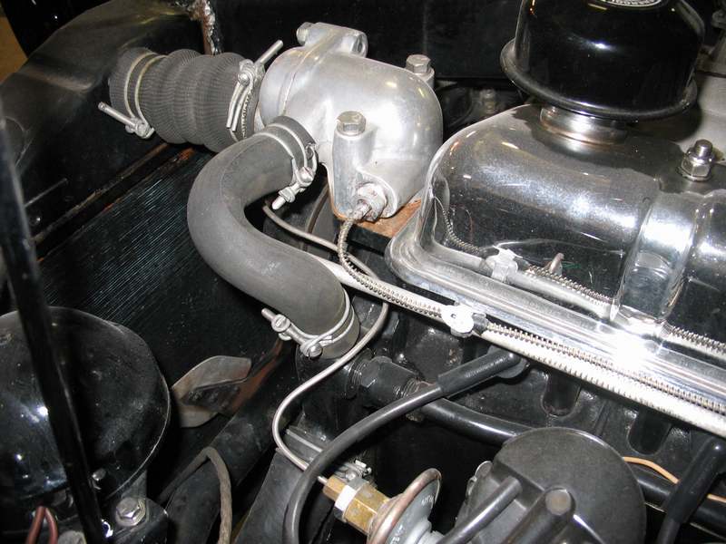

I have blocked the by-pass with a threaded brass pipe thread plug where I drilled a 1/8" diameter hole to allow air to bled past when I fill the cooling system. I also run an original 185 deg. sleeved thermostat.
Aha ! Your secret is out now, Don, you can kiss those two points goodbye !
