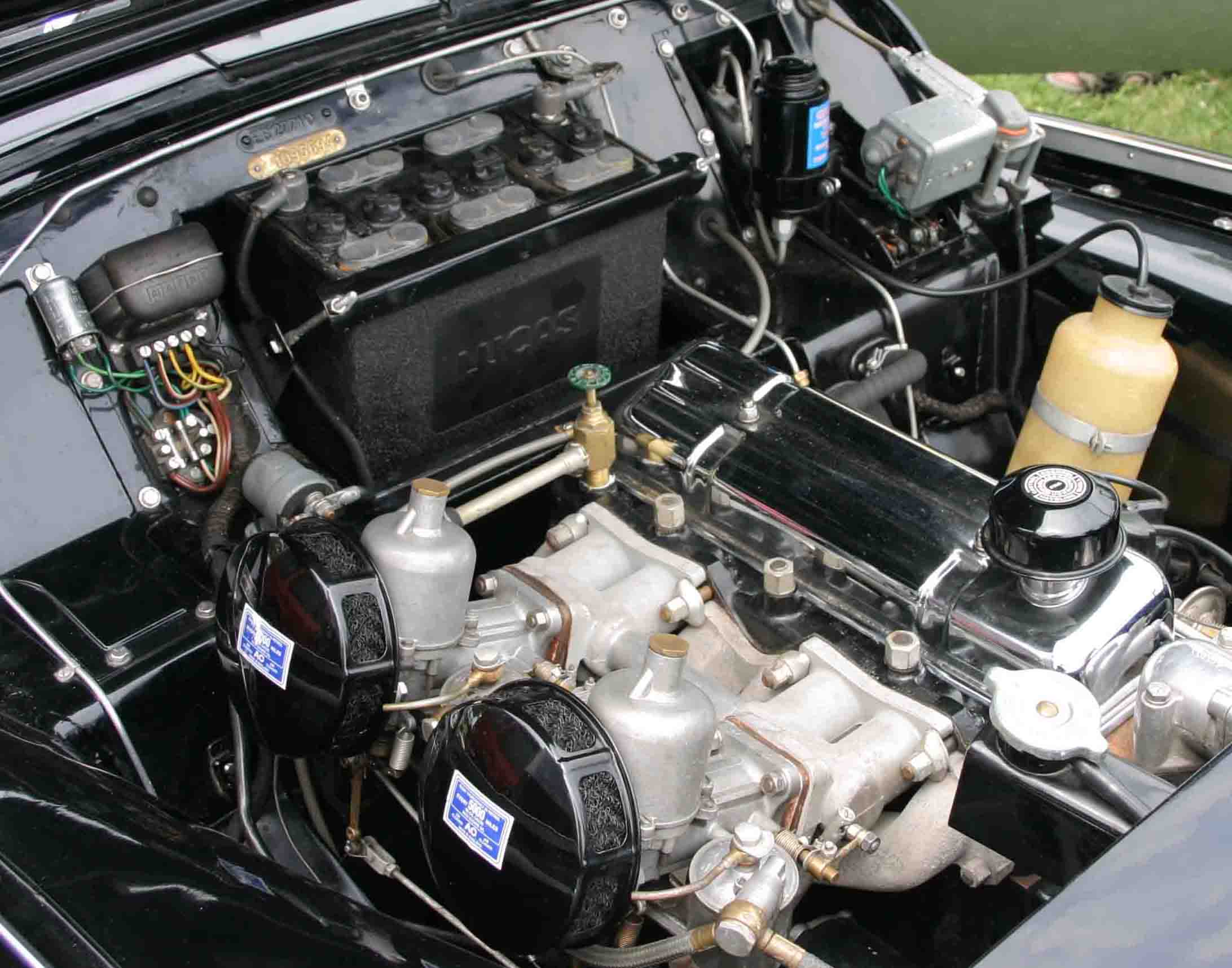

The cars left the factory in Coventry with the holes for the nozzles. They also had the rubber washers and the chromed washer nozzles installed too, even if the washer system was not installed. I bought my TR3A brand new from one of the four S-T dealers in 1958 herte in Montreal and he drilled a hole in the dash (where it pleased him) and he installed the push plunger - also the bottle because I ordered the optional windscreen washer when I bought the car new. It was a dealer installed option, but the nozzles had already been installed at the factory.

I don't think they all left with the holes ... TS13571L doesn't have them and I see no signs of them being repaired. Maybe there was a change point or something, I don't know.
As noted, the pumps were usually dealer-installed, and they put the holes more or less where they felt like. But the one on TS39781LO is a mirror image of what's shown in the handbook.
Oops, forgot to add, Don is right about the factory putting nozzles in the holes (when they drilled the holes). But I managed to lose the nozzles for TS39781LO when it was being painted, so for a few years I ran around with 1/4" bolts & nylon washers in the holes /bcforum/images/%%GRAEMLIN_URL%%/grin.gif
