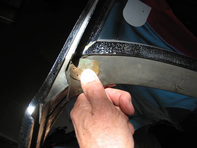

My TR3A did not have the corner finishers in place when I removed windscreen so, can someone provide me with a picture of proper placement or a good explanation of over what/ under what and when in the sequence of assembly they need to be installed?

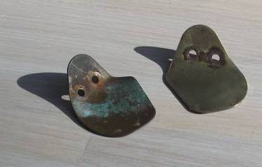

Do you mean these ones ? They are intended to keep pressure on the rubber seal to keep rain-water out. They are held in place with tiny sheetmetal screws with a tapered thread - much like a wood screw.
If you don't have any, you can make them out of brass shim stock about 0.015" or 0.020" thick.
If you mean the "L" ones that screw the the bottom corners of the frame together, they are available from Moss.

I purchased the pieces from TRF, just needed clarification on placement.
The pciture was exactly what I needed.
Thanks for that Don!
