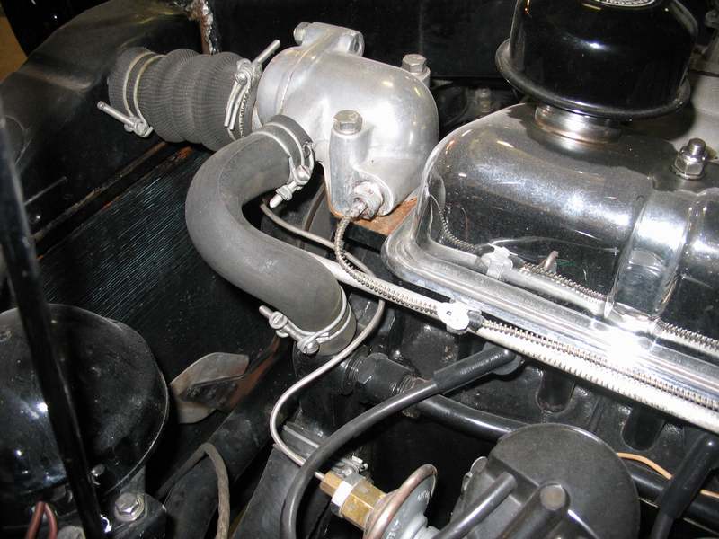

Where I was working in 1990 as I was finishing the re-assembly of my 1958 TR3A, the scrap bin at work had all kinds of stainless steel bits of sheetmetal and tubing. In a few minutes, I found a length of stainless tubing exactly the same size as I needed. I cut it to length and put the original fittings on each end using the proper flaring tool and it has looked super for the past 20 years.
