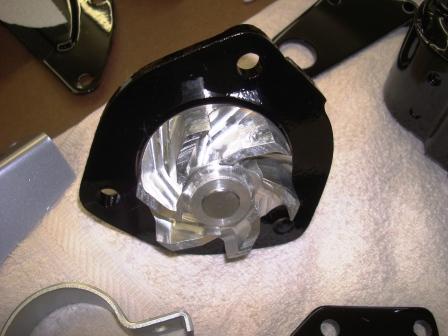

I agree (as usual) with Moses. However, we are going with an upgraded impeller.

I hope that you are right. With a fresh engine we really didn't believe a pump upgrade was necessary. However, we went with this design because the new (repro) impellers looked so bad. The castings were very rough and the impeller width was less than the originals as you have stated.

Nick: Even though we are starting with a fresh-end engine, we went with the upgraded pump (from the UK) because we knew that this person sold a quality item, we had seen demonstrated a few years back (at Stoneleigh). We actually had started with a standard replacement from one of the big three here in the states and it belonged in only one place. The bin. :madder:

I held one of each pump in my hands the other day, pondering if I wanted to try the 6-vane version. The original impeller has considerably larger blades and I find it hard to believe that smaller vanes work better at low rpm. The original has been said to suffer from cavitation problems at high rpm; and probably does for the racers who are turning over 5000 rpm for extended periods of time. The redesigned impeller would have far fewer problems with cavitation due to it's smaller (and more) blades, plus the curvature of the blade.
Ultimately, I put back the original pump (which appeared to be in perfect condition, implying no cavitation). The backflush with water mixed with air plus blocking the bypass appears to have done the trick; the engine actually runs a little on the cool side now. So the experiment with the 6-blade remains on the shelf for another day.
BTW, some early versions of the 6-blade pump did not have clips to locate the shaft in the bearings. That made it easy to move the shaft slightly when installing the pulley, which would cause the seal to leak. I doubt there are any of those left on anyone's shelf (except mine); but it still wouldn't hurt to be careful not to apply force against the bearings when installing the pulley.
