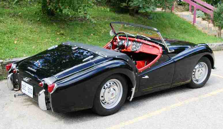

I restored my 1958 TR3A finishing in 1990. I had all the panels, doors and the fenders painted separately. Then in 2007, I took them all off again to have them re-sprayed because of stone chips on the outside and a few up under the fenders. There was no rust at all - anywhere. I have no seam sealer or dum-dum in the joints but every joint was pre-painted face to face.
I have no undercoating. In those 17 years, I drove 94,000 miles and I'd guess that only about 4,000 miles was driven in the rain. I park the cat inside when I'm at home and I only drive it in the summer. I wash it about 5 to 10 times every summer. It dries in about 10 minutes.
If you plan to drive in the rain a lot during the next 50 years, then, go ahead with the undercoating. If it's raining, are you going to go out in the TR for a quart of milk ? Or would you use the family car ? If you are planning to drive your TR only in the sunshine, then you don't need undercoating.
I bought my TR3A brand new in May 1958 and one of the options was "undercoating". It was the worst decisions I could have made. The tarry substance they sprayed up under there dried out and split with cracks in it. When I drove in the rain, the water would go up the inside of the fender and get trapped in the cracks and it collected in the "envelopes" where the undercoat had separated from the inner surfaces of the fenders. It would be wet there for days. In 1987, during the restoration, I had to MIG weld into place all new captive boxes and seams because of the rust.
If I were you, I wouldn't apply any undercoating.

Amazing car Don, just fantastic. Keep in mind though that Lyle lives in Florida, and it is humid and frequently wet with rain storms that can blow up out of nowhere.

Don, your car looks great!

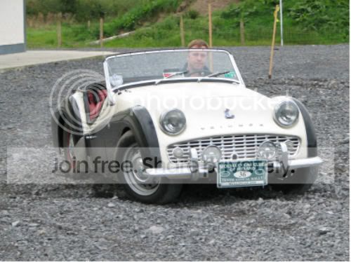

I undercoated my TR3 17 years ago and have since sprayed it a few times with Waxoyl to keep it pliable. However, I noticed last year that there were a few stone chips that had penetrated through the undercoat and paint and the rust had spread to the size of about a quarter (notice how I am picking up the language!!) I have since sanded and brushed the rust, treated it, repainted and then undercoated the areas again.
I use undercoat because I use the car for the occasional historic rally when it is used on rough roads and a lot of stones fly up into the arches. If I only used the car for road use, I would just paint under the wheel arches - even in this rainy Scottish climate. That way any chips would be visible and could be sorted quickly before any serious rust forms.
Not a TR3 I know, but my TR8 was never rust proofed. I drive it rarely in rain and never in snow. I wash and wax it regularly during the summer months. It is 29 years old now.....
I have zero rust anywhere on the car.
When i get a hold of a TR3 project, I intend to paint everything, but no rust proofing or dum-dum in the joints. The research I have done so far suggests it simply is not necessary based on how the car is used ( sunny day drive about).
My two pence (see I am picking up the language!) :smile:

Yes, it happens all of the time, regardless of whether I am in the car or not!!
angelfj said:
Nick, when was that photo taken. I could have sworn that you converted to right-hand steering!
Frank,
That was 2007. The car is still left hand drive. It doesn't have the holes in the bulkhead for rhd steering and I keep telling myself that I should move to somewhere hotter in Europe where they drive on the right!
Nick
