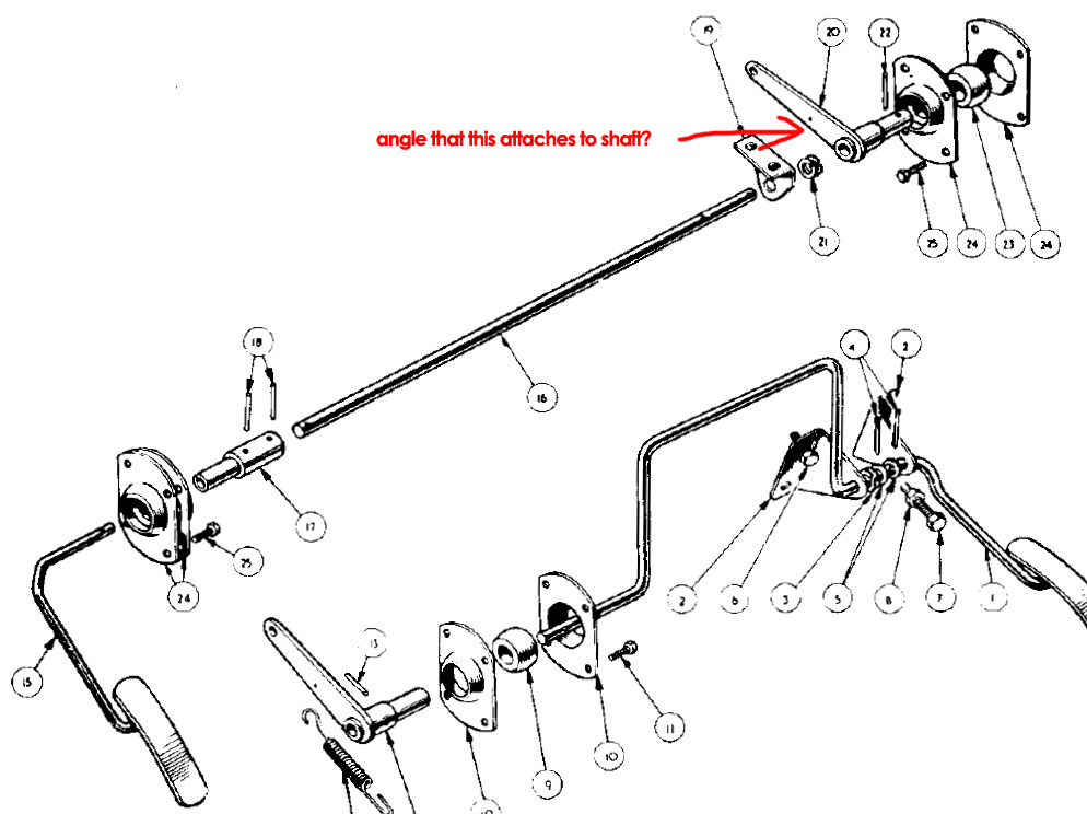

With everything back together I have a new weird problem- the throttle linkage is binding somewhere between the firewall and the front carb once the car warms up (at least that's where i think it is. When it's hot, the linkage wants to stay open about 10%. Interestingly, it's worse when I put it in reverse, which makes no sense to me.
While cold, the linkage returns to its proper place easily. All ball joints are new and lubricated and return spring is new, and I installed brand new nylon bushings on both sides of the linkage rod that runs behind and perpendicular to the engine, so I'm somewhat mystified. I have a feeling the geometry may be slightly off- ie the lengths of the two link rods may not be set correctly. So, does anyone have measurements of the long and short link rods and/or pics of their linkage that they could share? I'm particularly interested in the angles of the throttle lever that attaches to the throttle shaft and the lever assembly that attaches to the pedal shaft- I have no idea what stock looks like.
Here's two pics that hopefully illustrate what I'm talking about. Cheers in advance.

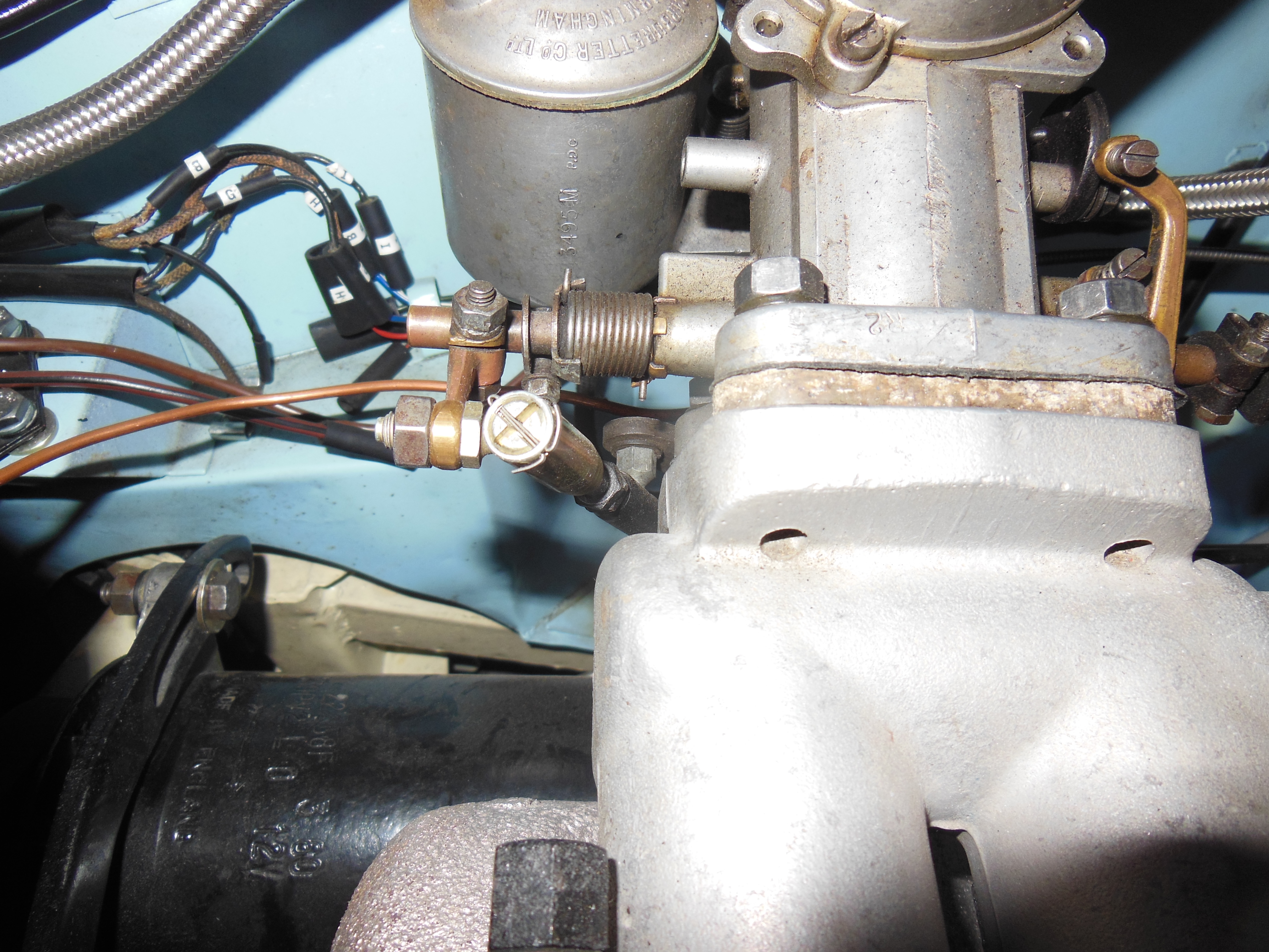

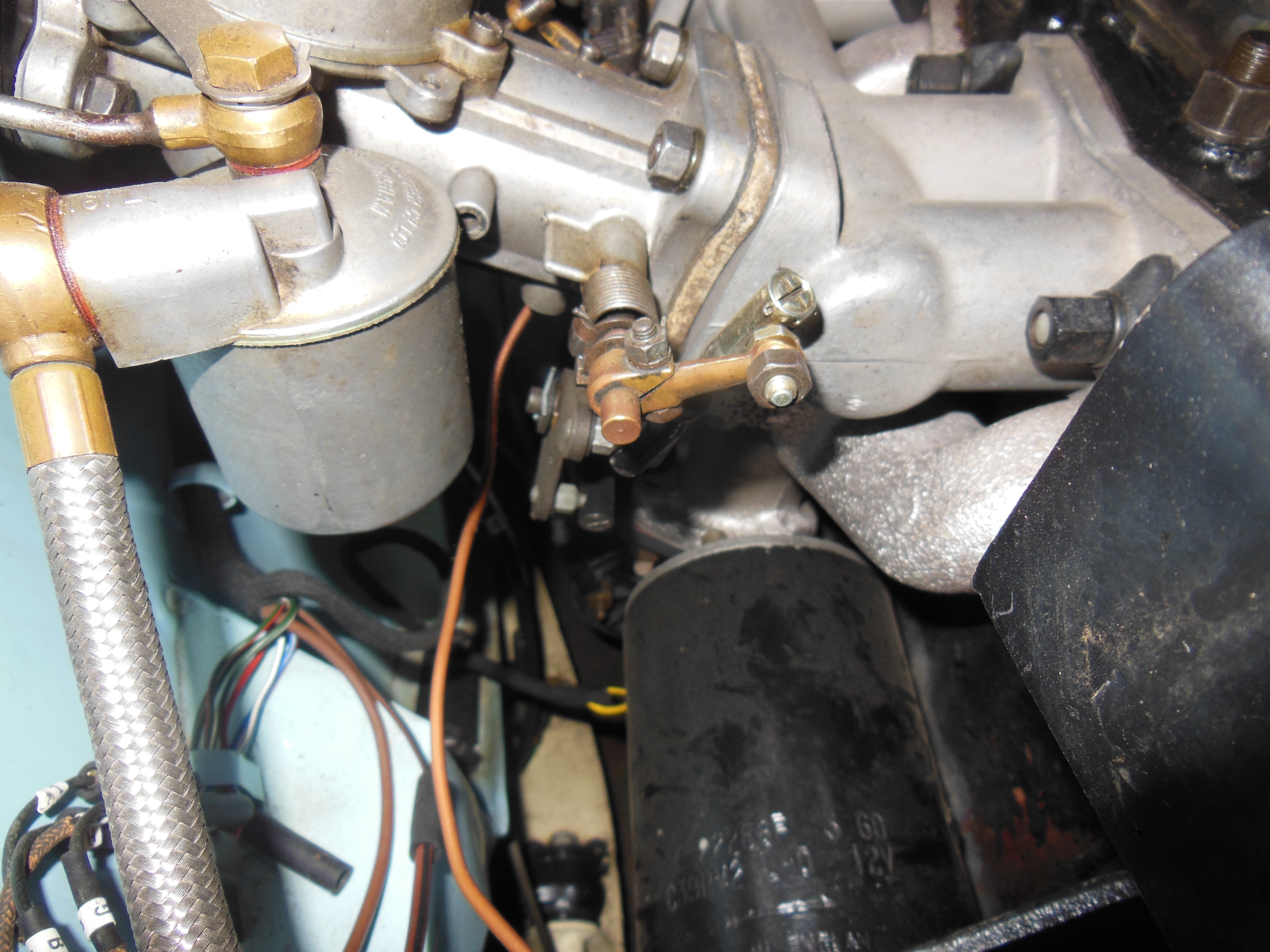

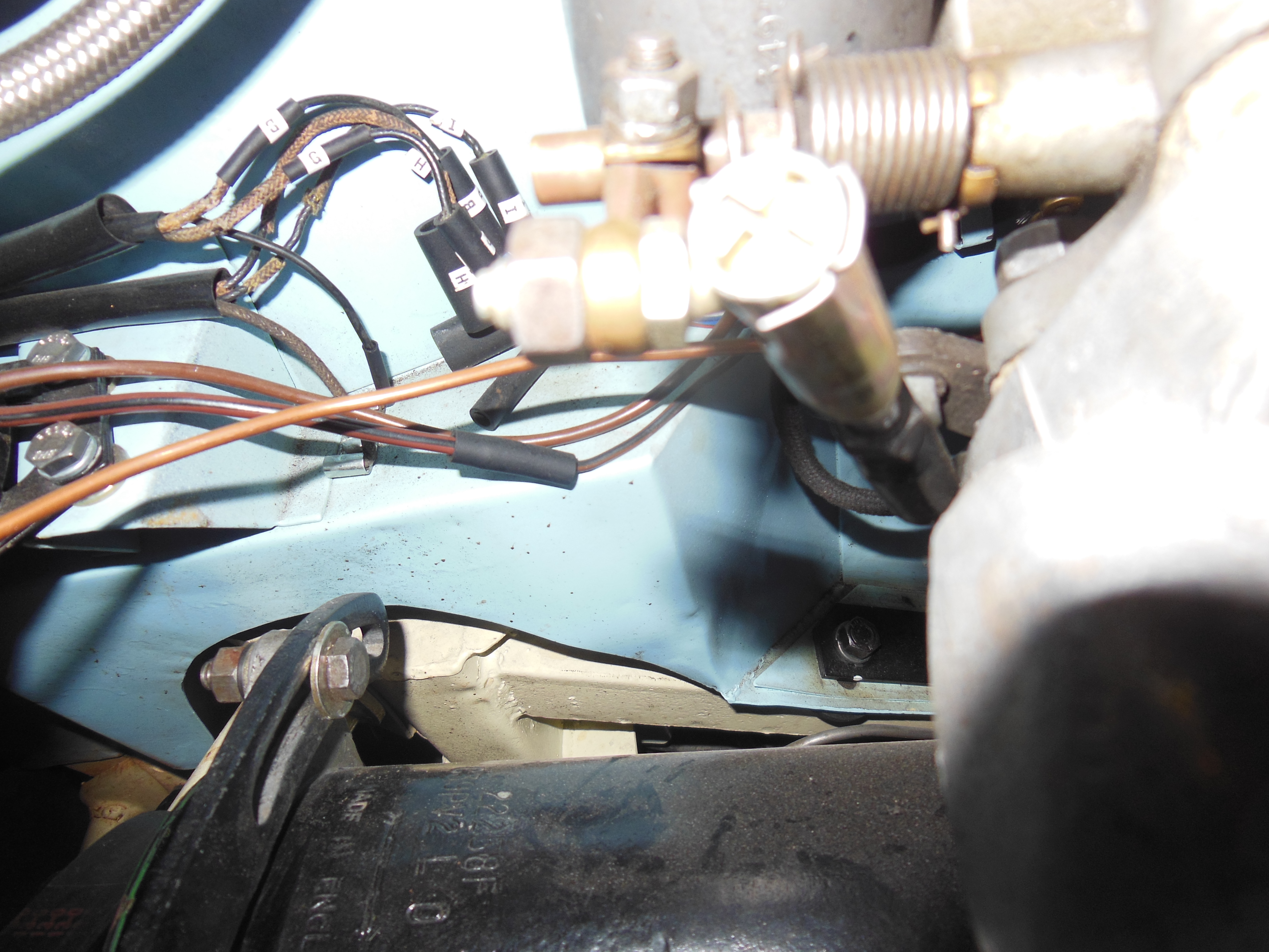

Here are some pics I took of my engine. I am not sure what spot you need, or if I have mine the exact way the linkage should be set. I am curious what you mean about the linkage. Are you saying the mechanical parts of the linkage bind up when warmed up or the engine idle rises and will not come down after the engine is warm?
The rod that wants to rub on the manifold has always made me wonder if I have it correct, but I have had apart so many times that this seems to be the best orientation.

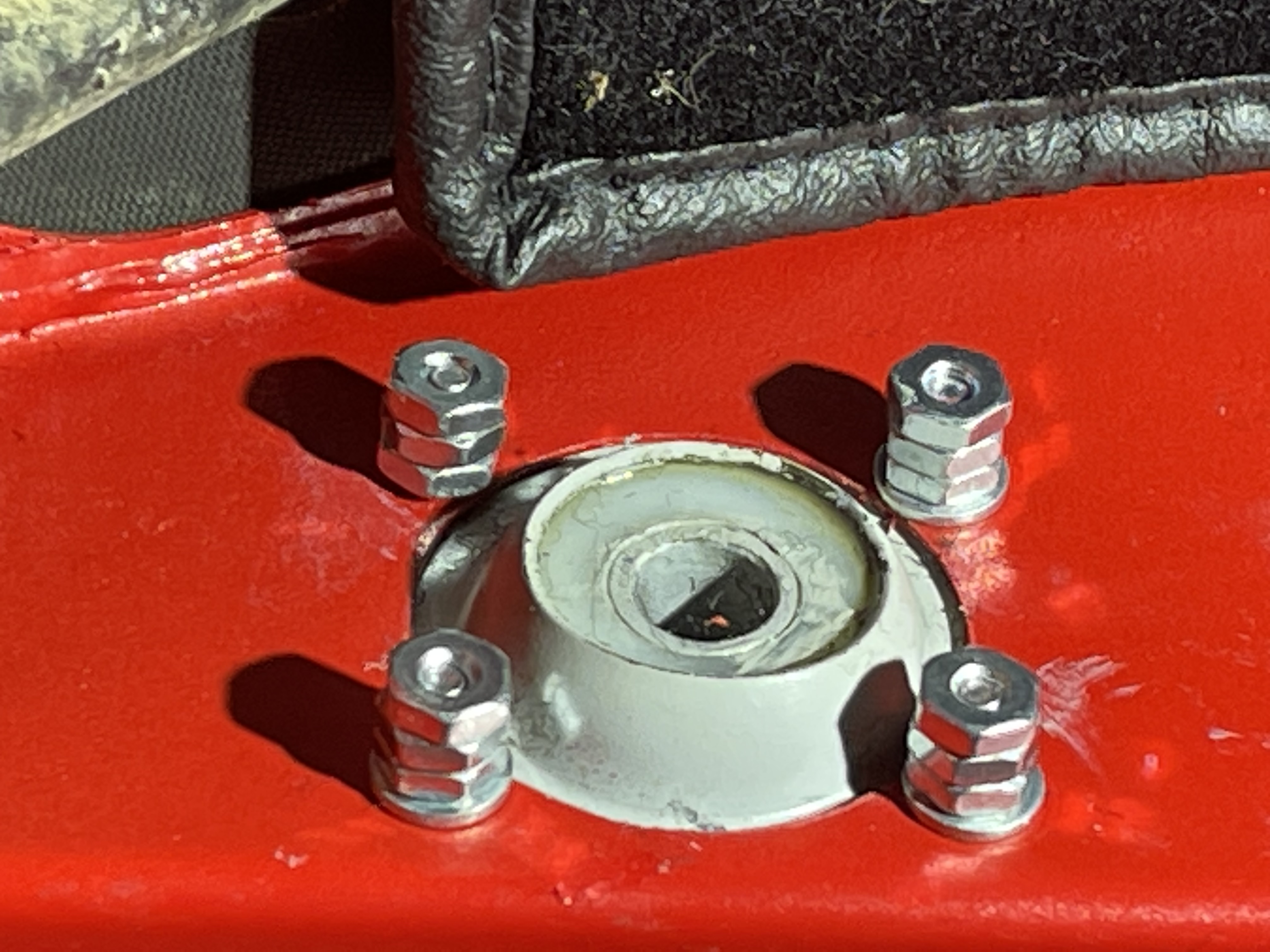

It's odd, at first I thought it had to be the Teflon balls on the firewall but the more I dug into it a lot of feedback indicated I should check the linkages first. The ball pivot piece has a lot of slop in it, instead of swinging left/right it almost twists up on an angle and very sloppy. So I've decided to replace all parts and levers that have a pivot point. Start with that first, as I really don't want to deal with the Teflon balls on the firewall. They don't have a lot of miles on them so it can't be wear. Does anyone lubricate those Teflon balls by chance? I did put them in dry.
Just to follow up on this thread. When I separated the linkage from the firewall rod it was obvious the Teflon balls were tight.
Loosening the 4 self tapping screws helps immensely but then you run the risk of the screws falling out.
In hindsight I wonder if the shaft shouldn’t have been painted at the Teflon ball point, I dunno.
So I replaced the self tapping screws with loosely tightened #8 threaded screws and double nutted them (triple nutted actually bc of the first wrench width) with the outer locking nuts loctited on the inside. So far so good fingers crossed!
