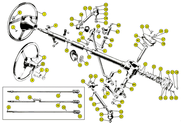

TR2/3/3A tr3 steering
Aloha Lyle,
I bought mine a few months age from The Roadster Factory.
https://www.zeni.net/trf/sampler/20.php
I suspect Moss and others also offer the replacements.
It seemed to me that the hardest part of the replacement was removing the old silent bloc bushings. The new delrin bushings fit in nicely. I removed the center tie rod from the car and did the remove/replace on the bench which made it easier.
Since you have most of the steering apart now, take the opportunity to disassemble the steering idler arm to clean it up and regrease it.

Dave, I removed the center rod and pressed out the old Silentbloc's like you did.
The pins look like new, just the rubber bushing was hard and dry rotted.
I have some Delrin rod, I will just make some bushings. I will make them a 2 piece design with a head on both top & bottom, that way it will keep the center rod positioned better.
I have the idler arm and bracket out.
It has some wear.
*Up & down movement is about .015" to.020"
*About .005-.006" clearance between shaft and bushing.
I don't want to get crazy replacing everything!
The threads control the up & down movement, not much I can do with that, without buying all new parts. Not sure how much movement is too much?
The bronze bushing in the idler bracket is worn. I removed the old one today & will make a new bushing.
Delrin or bronze?
The seal between the idler bracket and arm is not available, so I will use a soft rubber washer or maybe an O-ring to keep dirt out?
Lyle

Everything is back together and leak free!
I made Delrin bushings for the old Silentbloc pins, they worked out great.
Also made a Delrin bushing for the idler arm bracket, and used an 1/8" thick O-ring as a seal.
New steering box seal, bushing and gasket.
Rotated the peg 90 degrees.
When assembling the box I put a very thin layer of permatex between the shims and gasket. Also I noticed one bolt that holds the cover plate on is a thru hole, so I permatexed that to.
The brass Olive was cracked, so I made a new one.
Adjusted the peg, steering feels tight but not to much drag.
Very happy!
Thanks for the help everyone.
Now I can put my front apron on and get this car on the road!!!!
