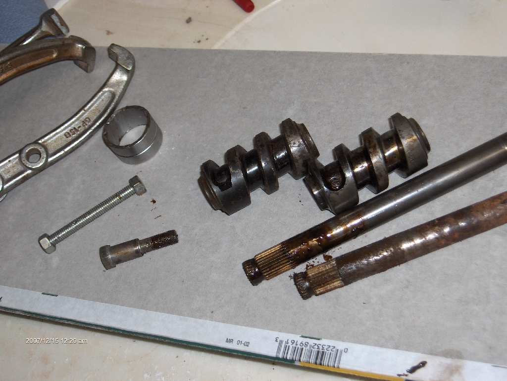

There was a discussion here a while back about removing the worm (cam) from the inner steering column. I copied and save the pertinent post from Harry Ward. here it is:
REMOVAL & REPLACEMENT OF TR3 STEERING WORM
"Wim Betzel, Netherlands
Hi all, ok the salesman told me it is piece of cake to replace the worm. Well, his brother the craftsman was not pleased on first attempt, because the old one didn't come off easy. His press is to short for the Rigid (one-piece adjustable) type column i have. The end of the rod is conical and holds the worm tight on the column which has a splined end. Because it was to late a had to leave it in the shop, so no pictures alas. Whats the trick. You need a heavy piece of pipe a little bigger in diameter as the column. Slide this pipe over the column and catch the end of the column in a good bench-vice. Then heat the end red hot and knock the old worm of with the pipe. So don't file the conical end of, because after installing the new worm you need to fasten it on the column again with a conical punch! A weld can brake easel when you hit a pavement.
Next Monday i will pick up the column, so i can take some pictures.
Regards, Wim."
From British Car Forum, Triumph Forum, Steering Box TR3, #199695 10/11/06
Here is a link to another discussion regarding the removal/replacement of the worm gear.
https://www.tr-register.co.uk/forums/lofiversion/index.php/t4450.html
It seems to be possible if you have a torch, a good vise and some black smithing skills. Perhaps you should practice on the worm with the nicked sides first.
Hmmm, heating a ball-bearing race (on the end of the worm) red hot doesn't sound like such a good idea to me. Generally heat-treat is fairly critical to ball bearings and I wouldn't want to mess it up. Seems like that worm is likely heat treated as well.
I like the TR Register version better.
But YMMV of course. Thanks for the info, Dave.
Aloha Randall,
I am pretty sure that your assumptions that the worm is heat treated or at least case hardened is correct. I think that perhaps the description "red hot" is an exaggeration. I think the heat needed to expand the worm and loosen it from the inner steering column would be less than that. Another concern would be the potential damage to the bearing race from the piece of pipe used as a slide hammer battering against it. I think for peace of mind some type of collar or washer should be used as a sacrificial piece to hammer against.
Thanks, Dave.
I'm glad I kept those worms on bad shafts now.
Aloha John,
A quick check with "ask Jeeves" seems to indicate the temperature for tool steel to glow red is about 1000 degrees F. I would think heating the worm to about 350 to 400 degrees F, a pale yellow to straw color would be sufficient to remove it from the inner steering column. Reinstalling it might be easier using an oven to heat the worm and some ice or dry ice to chill the shaft.
I was getting ready to try this myself, to put a good worm from a non adjustable steering column on an adjustable steering column. I have since discovered it seems easier convert to a non adjustable steering wheel. I have been taking notes and photos so I can document the conversion.
A friend with a TR3A had a sportscar repair shop replace the worm. They "said" that they had to send it out to a machine shop who turned it off in a lathe. They put on the new one he supplied and they charged him a fortune for the job. Shop around.
From the trf forum "Once the old worm is off thats the worse bit over" -if that's the case, then the worse bit is over. I used a regular 3 jaw puller and had an old shoulder bolt that fit inside the cam, but pressed against the shaft. On the other end I used a cut off part of a foot peg (that spins onto the axle of the front wheel of a BMX bike) because it fits around the bearing race, but against the cam. As expected, the shoulder bolt wasn't long enough, but it's tightest at the begining, and once the shoulder bottomed out a, piece of all-thread with nuts got it off the rest of the way. No heating at all.
Haven't tried getting it back on (yet), but I was able to pull two cams off without damaging anything.
The only down side to all this is that it encourages me to save all the scrap bits from everything because you never know when they might come in handy.
Thanks for all the insight, and I'll keep you-all posted.
Jerry
