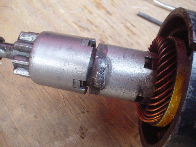

I have had no starter troubles since 2002 when I was at the races at Mosport, Ontario. After that, I had to put in a new rubber thing called a “Pinion and Sleeve” in my long-nose starter used on the early sidescreen cars and I had to buy a new pinion rubber sleeve
(see photo) that cushions the shock when the starter motor starts and the pinion spins out to engage the flywheel. It happened again yesterday (39,000 miles later) so I'll have to put in my welded spare (see photo) that I MIG welded together and used in 2002 till I received the new one with the moulded rubber inside it from Moss. Delivery was slow because I had ordered it by phone on 9/11 and there were no planes flying for at least a week or longer. This one seems to have
failed yesterday (Taiwan rubber ?) in the same way. Maybe this time I'll buy two new spares.
