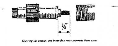

Check how far the new cable extends at the speedometer end. Some of them are too long, which puts pressure onto the speedo mechanism and leads to early failure. With the inner cable pushed into the outer cable as far as it will go, the inner cable must not protrude more than 3/8" from the outer, measured at the flange inside the nut.
