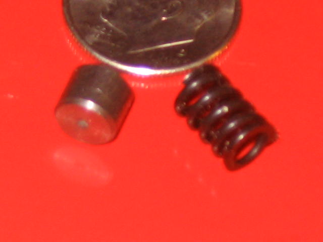

I have this exact problem in my '3. Moss claims that their replacement spring and small metal thingy will fix the problem. ISTR the spring is 1/8 inch shorter, and the small metal thingy allowed more play. Both those items are now sitting on my work bench. I regreased the area, put back the originals, and buttoned it up; it might have been a touch quieter, but I'm still seeking a better solution.... the Moss $3 answer ain't it!
Were you careful to make sure the pieces did not fall out during installation? It is common for this to happen. When installing, use some grease to hold them into position.
Here are the Moss parts I mentioned. I followed Doug's suggestion of applying grease to the old parts on assembly... if there are other ideas out there for getting rid of the rattle, besides a new HDVA 5 speed, I'd love to hear t!
