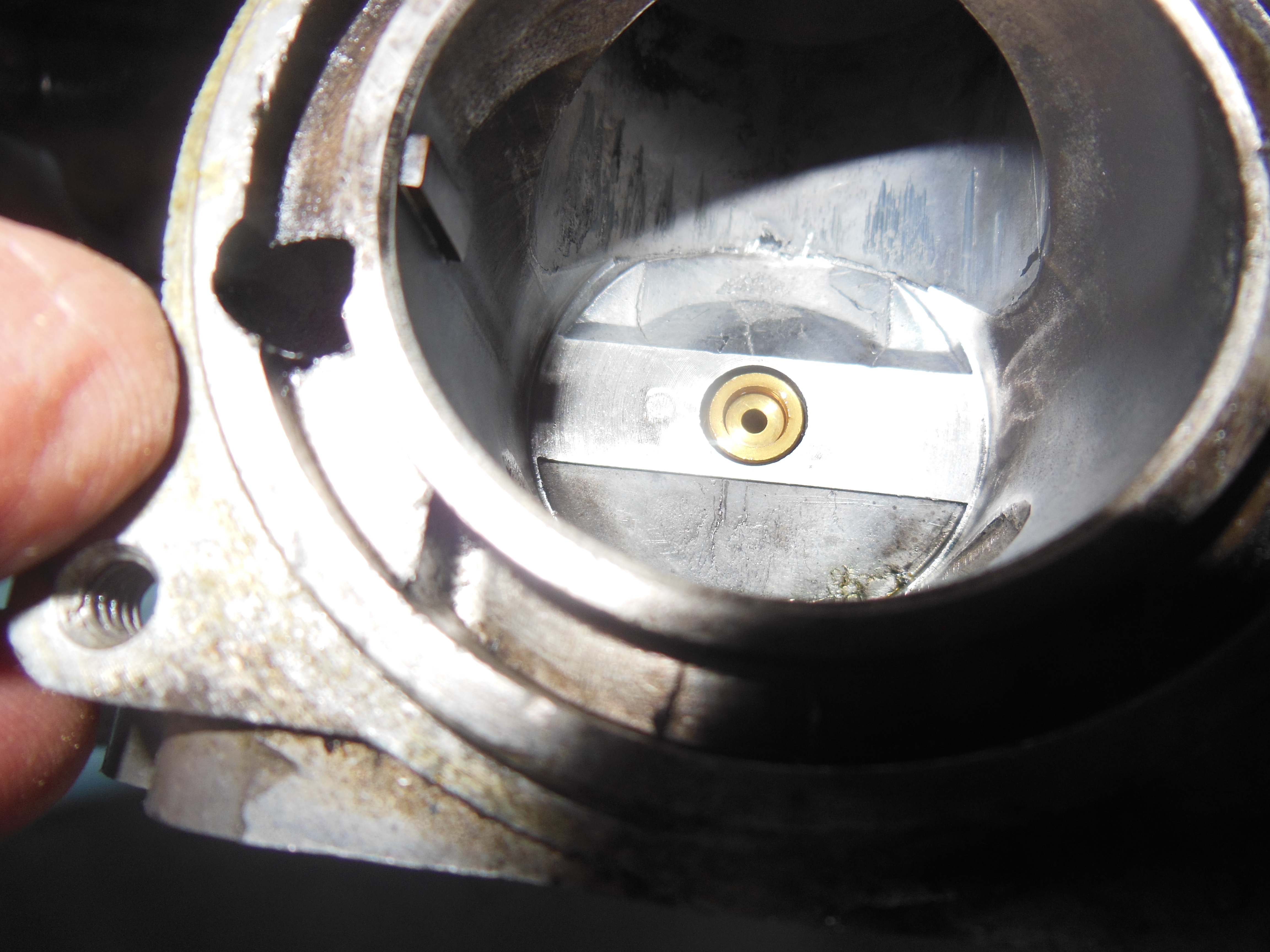

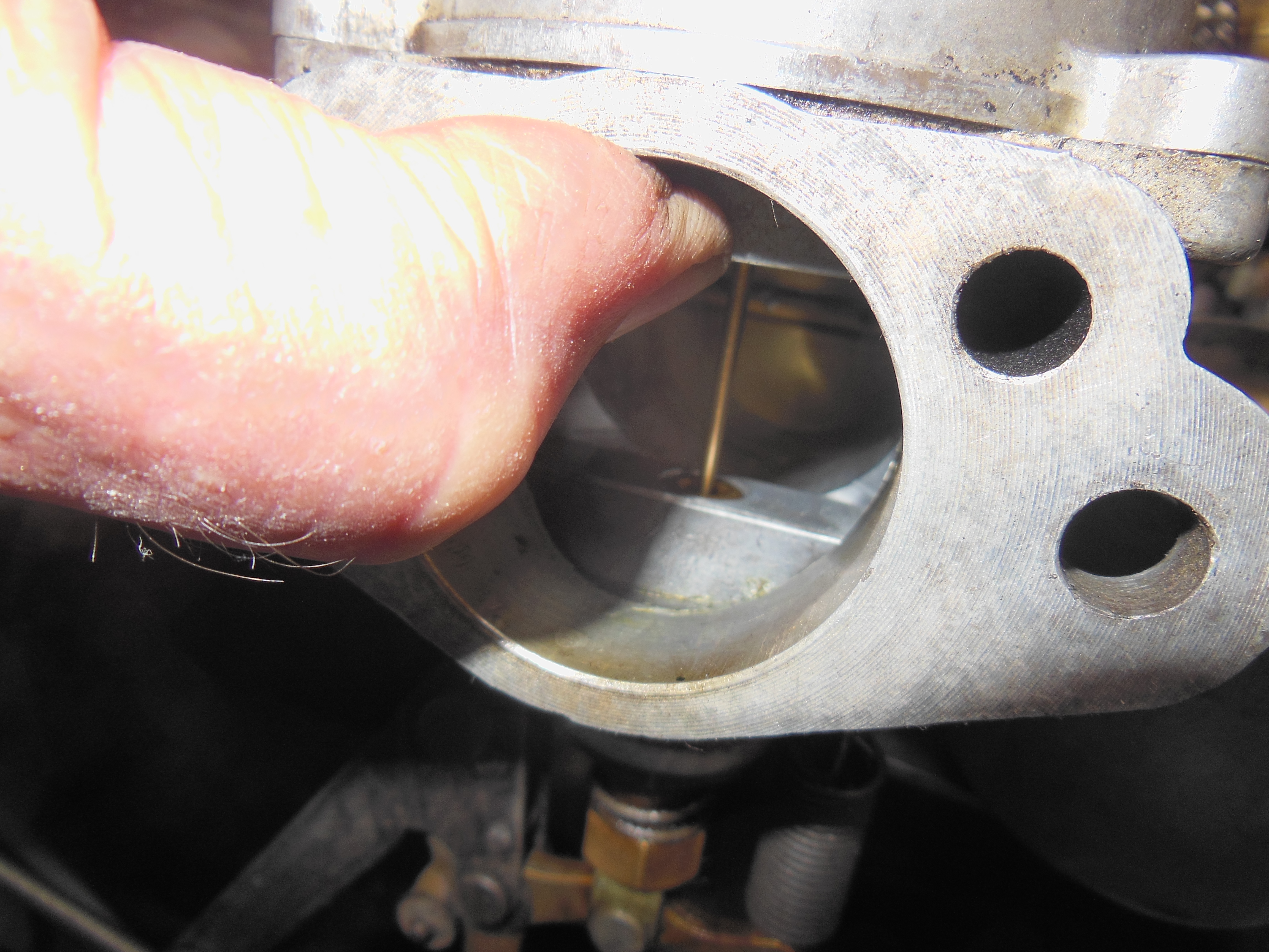

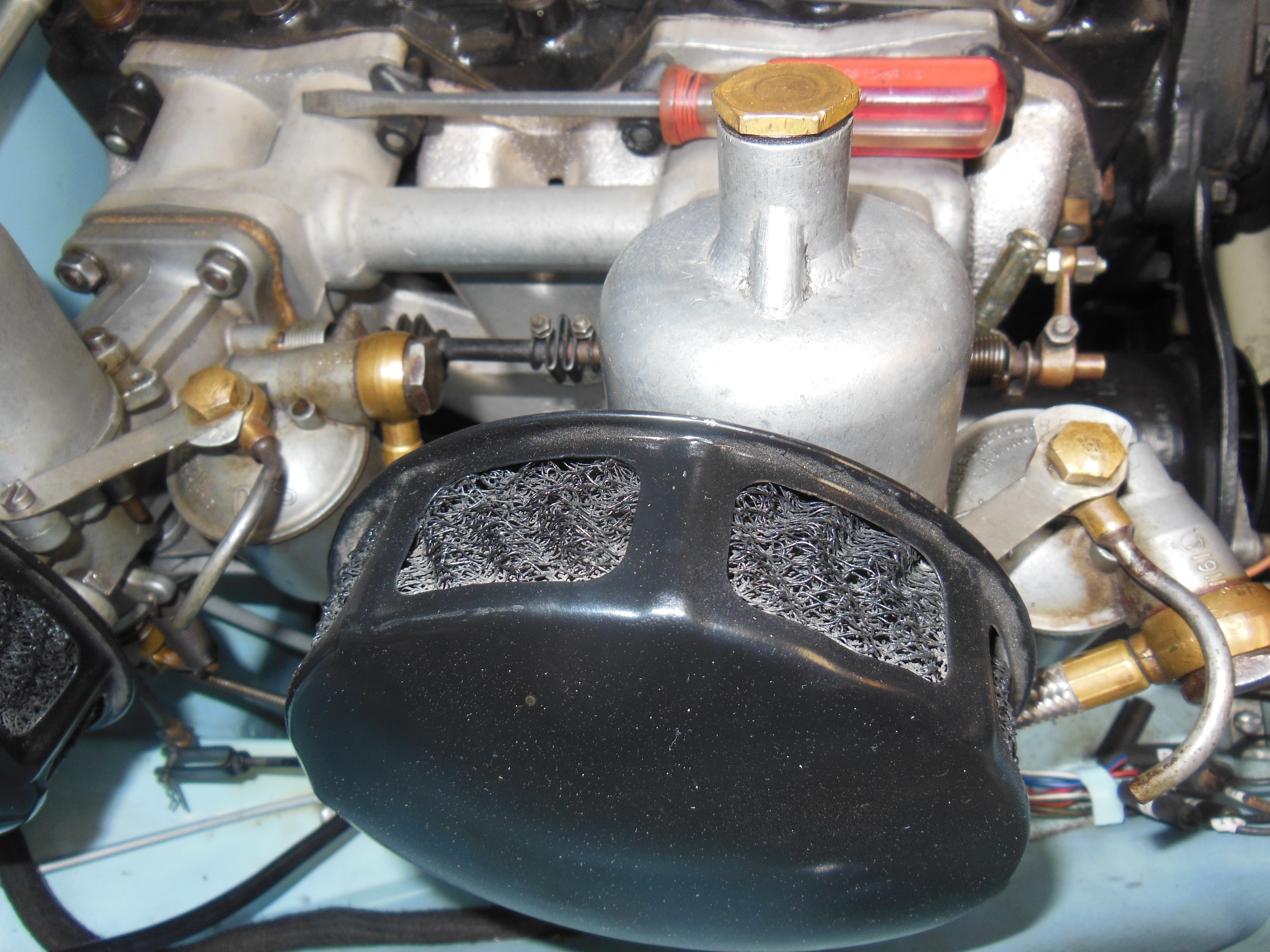

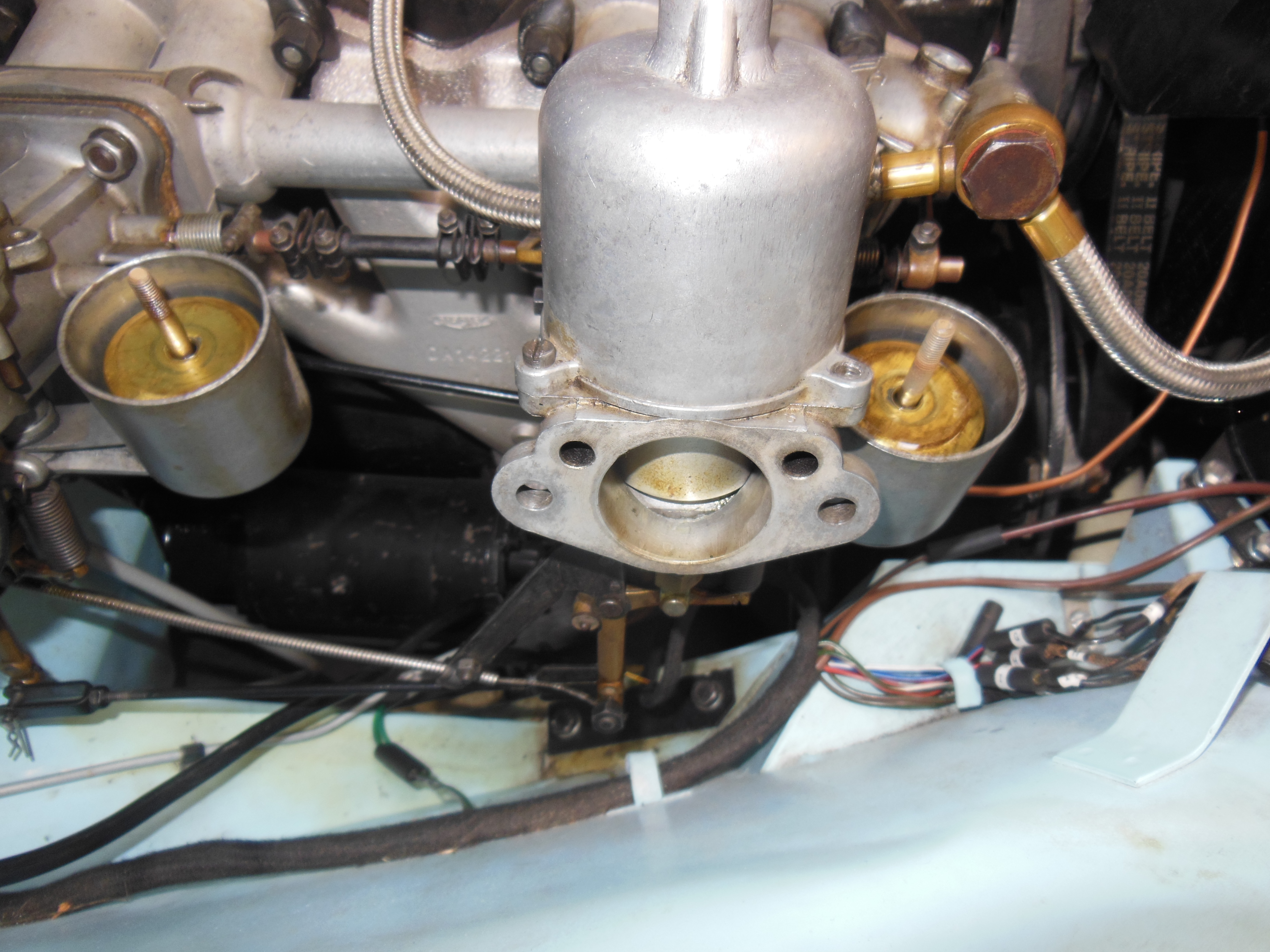

My tr3 sat all winter and when I went to start it all that it did was crank. This a car I thought ran great. I sprayed just a very small amount of starter fluid through the air clean and it fired right up. The spark and the timing must have been very close or it would not have started, and run so good now. I would bet the car will start better for months now it has ran once So what is the problem?
I removed the float bowls and the fuel level seemed correct. The float arms are 7/16. The only thing I can think of is the mixture on the jet nut is so lean not enough fuel got into the engine because the lean adjustment I have on the needle stopped it.
John commented that people should see fuel up at the top of the jet. I tried and could not see any fuel. The area was damp with fuel, but the motor had been running. The fuel level in the jet should be a gravity flow from the bowl line of fuel back to the jet, a horizontal plane right.
The problem with not seeing fuel could be float bowls are adjusted in correct. Do I need to briefly crank the engine to get fuel back into jet to see the fuel? Or should fuel always be visible and I need a flashlight. What are the thoughts on this idea?

Crank the engine without ignition and check that level is slightly below the jet top,like about 1/32-1/16"
This will tell you what adjustments are needed to the float arms before you remove the tops.
If this checks out crank it again just to check that level is holding,and you don't have a leaking needle and seat.
