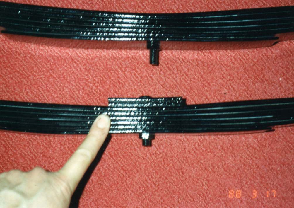

The rear leaf springs on my 1958 TR3A did well for 135,000 miles from new. Those clips on mine had gaps too. You get the gap because the leaves rub together and cause the rubbing surfaces to wear and/or rust as they flex with age. so the leaves get thinner and weaker and this causes the gaps. Mine were 42 years old. I suffered from a sort of "sashay" up and down on one side when I was driving on a smooth road with gentle rolling dips. Two of the leaves had become so thin, they had broken.
I suggest that for the price of new leaf springs that you replace them like I had to do. Since then, I've driven 45,000 miles on the new ones.
The one with the extra pad goes on the passenger's side in North America (on a LH steering TR).
