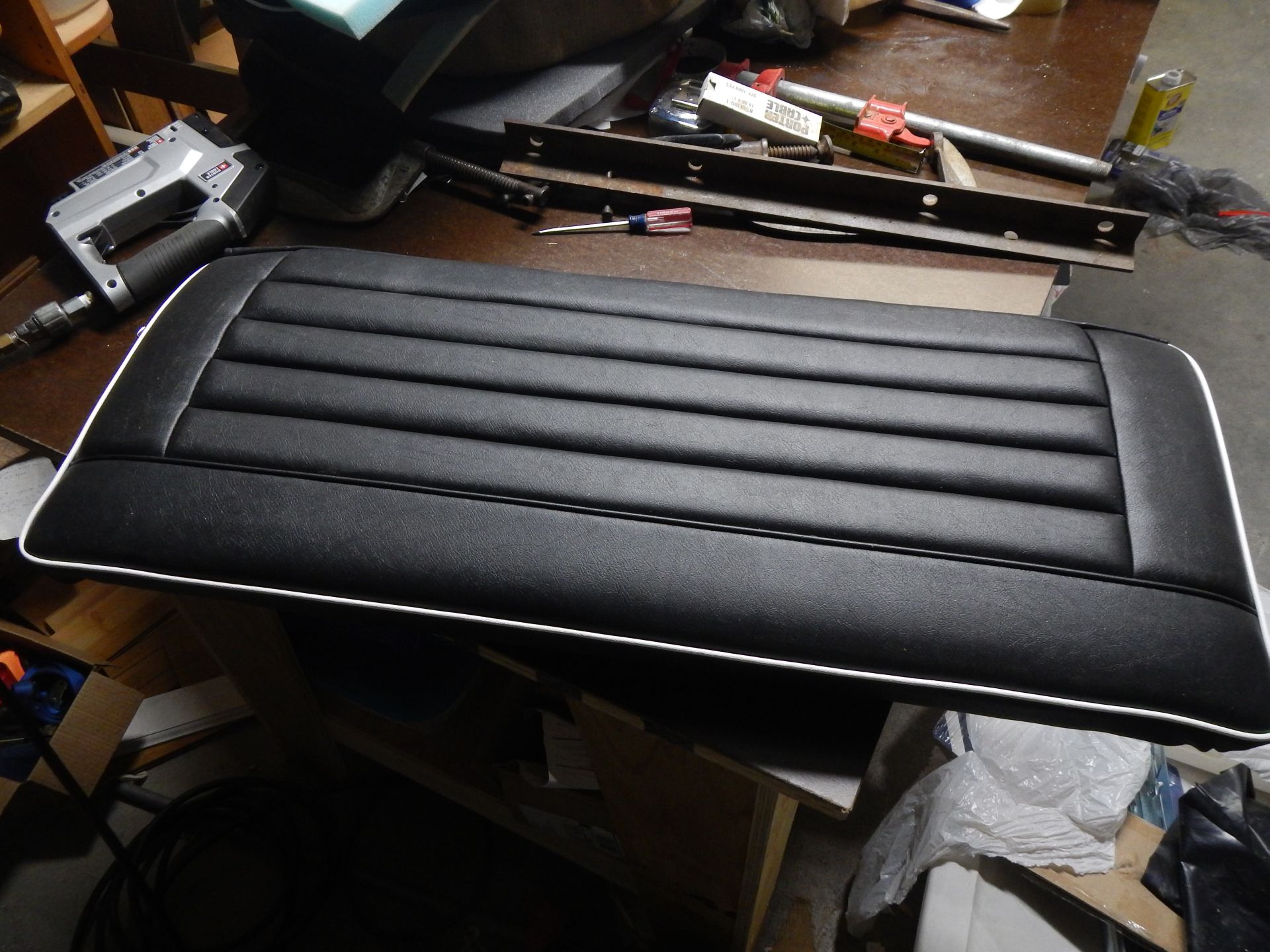

My TR3B has been apart so long I don't remember if it came with the rear seat bottom. The seat back is just a card formed and covered with some padding and vinyl..I cant find the seat bottom. I think the bottom design for a sloped car would fit my flat design just be removing the bracket but I'm not sure.
Does anyone have any seat bottoms available, cover and padding condition is not an issue as it would be used for a pattern...
Thanks for your time.
Just so you know - I think your car would have had the seat bottom with more squarish corners - the earlier cars having a seat bottom with a rounded forward edge and more rounded corners.
I you are willing to upholster whatever you get then I think all there is to the bottom is plywood and some T-nuts - in which case a paper pattern and maybe a photo would be enough.

An old cover might help my upholsterer. If I don't hear of one before 7/28 I'll just concoct a board and turn my guy loose. Just matching the seat back should be no worries for him.
This is the drawing I used to make my seat bottom. I got the upholstery and padding from J. Skinner in the UK.
David
Great looking seat David,well done. I will have to save this for when I start working on the interior. Frank
Thank you Frank.
I thought that the foam they had sent me was way too thick but after working on it for a while using clamps I managed to get it buttoned up. The seat is nice and firm but not hard. Leg room in the TR3A rear seat is LIMITED..
