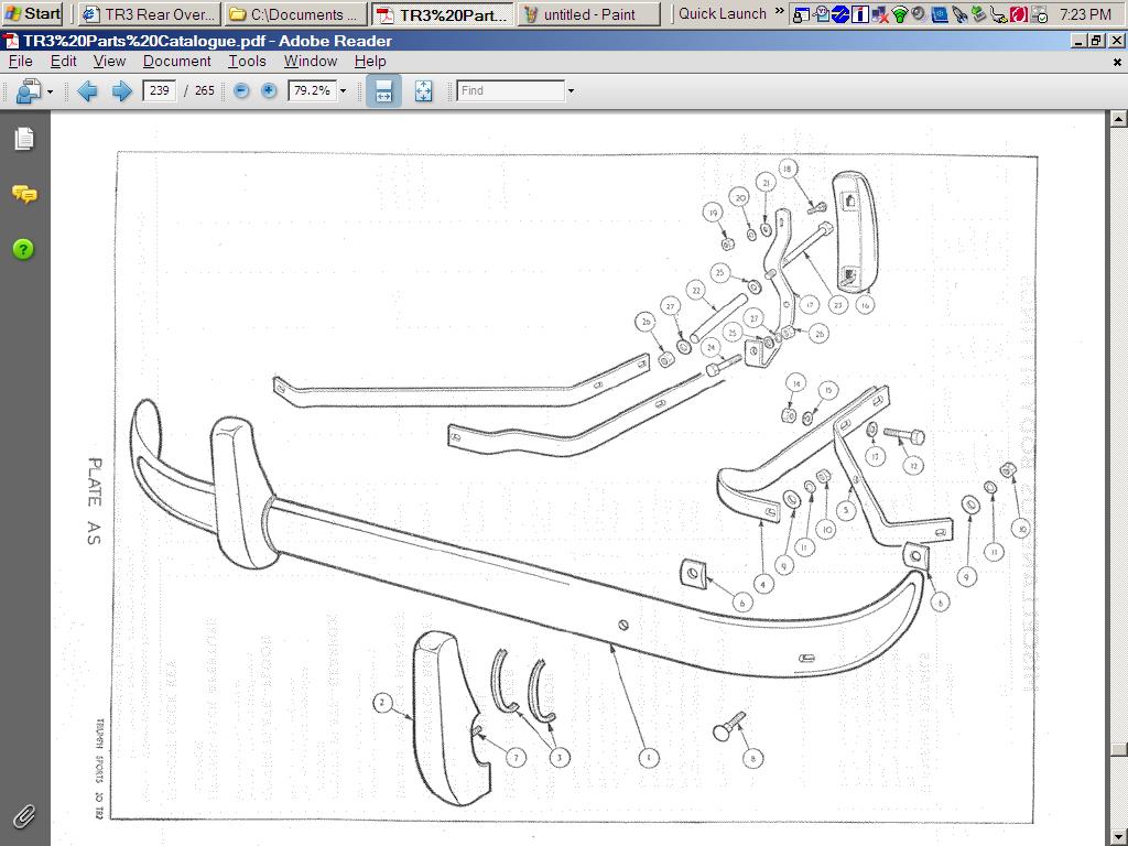

I'm getting ready to put on the rear bumper over riders, and am confused on which way is up. Is it the short or the long end (in relation to the brackets inside the over rider) that go UP. Hard to tell from looking at pictures, but gut feeling says long is up.
Art: does this help?

Aloha Art,
The long end of the mounting bracket (the bent flat bar that bolts to the frame)is up. On the over rider, the integral bracket for the bottom is adjacent to the bottom of the over rider and at the top the is a gap above the integral bracket.
Frank not only types faster than I do, he uses a picture.
Thanks guys, that confirms my gut feeling. :cheers:
