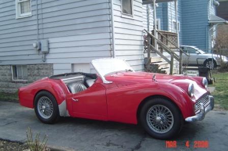

Later in this thread I attached a couple of photos of the car before our rebuild and current.

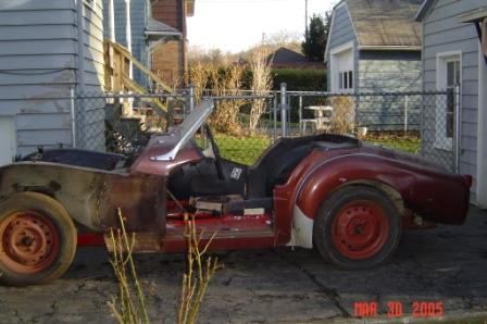

The Before Photo

Earl-
I'm sorry, but from your pictures and description of the temperature problem, you're car is a goner. Of course, I'd be happy to take it off your hands at a modest price.. /ubbthreads/images/graemlins/grin.gif NICE car, good luck with it!
Randy
