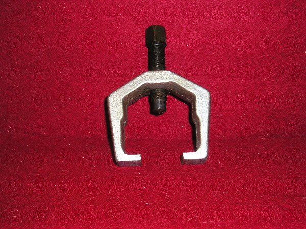

I too have the untouched 50 year old steering that I plan to address this winter. I plan doing exactly what Randall has described and re-bush all the rubber bits on the steering and suspension. For the time being though I wonder about adding some lube to the box as is, I haven't tried since it is a greasy mess and obviously leaking like a sieve. Although I just thought of this. I infrequently use a grease at work called cotton picker spindle grease (similar to 00 grease) I think it might leak less as that is what we use it for on an old mower that leaks like a sieve. I'm thinking that that and the silent blocks might give me a more enjoyable fall before doing any real work on it. Randall what Pitman puller does work and where would one get the right one, how wide do the jaws need to be?
Sorry, I don't know offhand. The stores were closed by the time I got to that point, so what I did was to make some side braces for my 2-arm gear puller, that forced the jaws to stay on the tabs on the arm. It worked, but it's not something I would recommend as good practice.
I had to tighten the forcing screw until I literally thought it would break if I went any farther, and then smack it with a BFH to get it to pop apart.
It doesn't take much of a leak to get really messy, so it might be worth filling it at least once with ordinary gear oil, see what happens. But if that does leak too badly, then the spindle grease seems like a reasonable idea. Several LBC suppliers offer Penrite "semi-fluid" grease for the same purpose, which is another brand of 00 grease.
KD 2289 pitman arm puller will work. Ears have to be modified because of narrow gap between box and pitman arm [grinding]. Slip puller on. Tighten as much as you can using a breaker bar. Hit tightening screw head with a large hammer,to shock arm loose off splined shaft.Doing it with steering shaft still in car will work for those extremely lucky people. I have always removed steering shaft.
PS remove top plate off steering box before using hammer to shock arm off.
Some where either in the states or Canada there is a pitman arm puller that I modified when I took my box apart. Maybe Don Elliot knows where it is. If you can locate it then it's yours to use for the asking. PM Don and ask him about it.
Tinkerman
I'm not to that stage yet but a picture of it would be nice. I don't mind modifying one when the time comes.

Eric, here is a picture of what I did to make it work. I bought an inexpensive one at an auto supply shop and ground it down until it fit under the drop arm. I popped it with a big hammer before I took the nut off just cranked away with a 1/2 inch drive breaker bar on the puller until I heard a loud pop and off it came.
Cheers, Tinkerman
