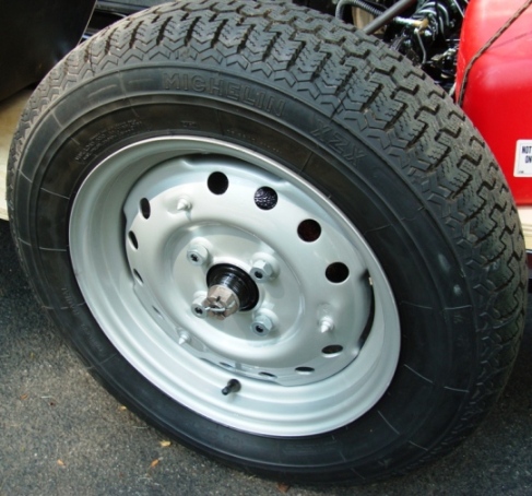

These are my stock steel wheels probably 4.5". It's TS66 somthing. I was hoping for a better selection of tires. Not much out there. So 165/80/15 is the best size? The one problem that I don't want to occur is to change my speedo accuracy. It's spot on. I'll keep the spare I have now. It's only seen 500 or less miles and it's a tight fit.
I have Kuhmo 165/85's on a TR3 4 " rims and 2 sets on 60 spoke wires (TR4 & BJ8 A/H) Can't beat them for the money. You can buy almost three sets and wear them out for the price of one of the high dollar brands. Don't think you would like 185/65's (even with wider rims)on the TR3, they look too small and would probably change speedo accuracy a little.
Can you still get 165 XZXs? I saw a couple of sets on cars at TRA and was wondering how old they were.
Now, back to the point, there aren't many choices for 4.5 rims, but the Kumhos and Vredesteins can't be beat in terms of quality and price. I went through the same agony last year--trying to find something different--and came right back to those two tires.
