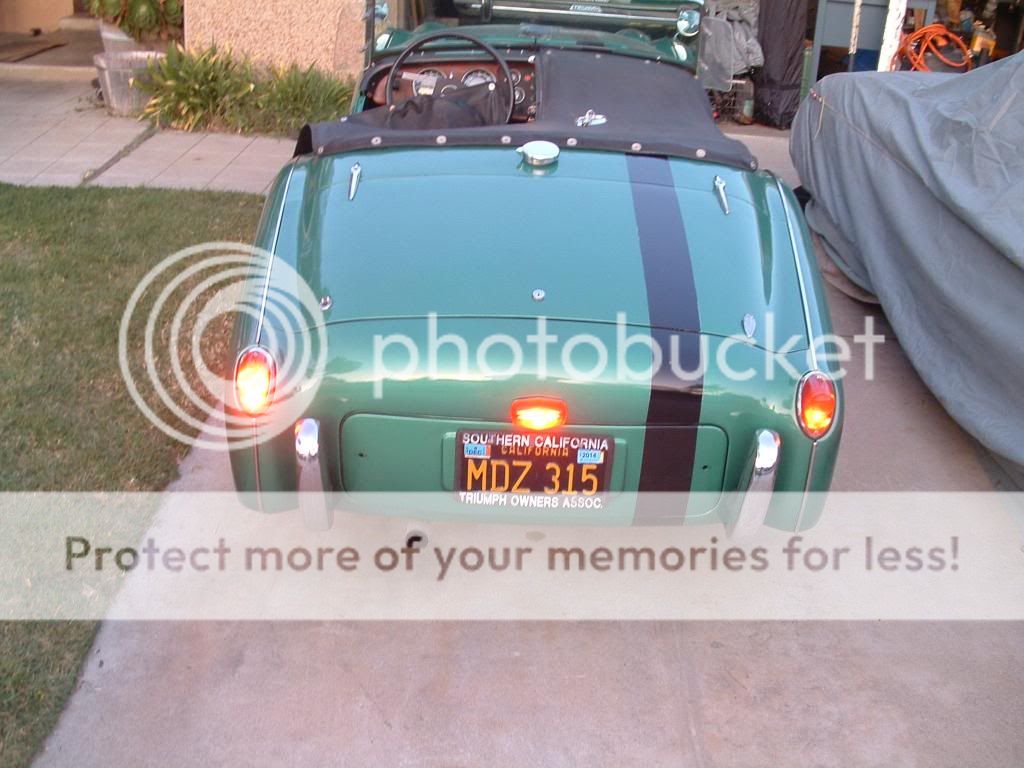

I've been playing with making my own, with mixed results so far.
The camera doesn't really do them justice, but here's a daylight shot. The RH light is still incandescent, but an uprated bulb that is quite a bit brighter than stock.

Wow! Even in broad daylight that;s a big difference.
