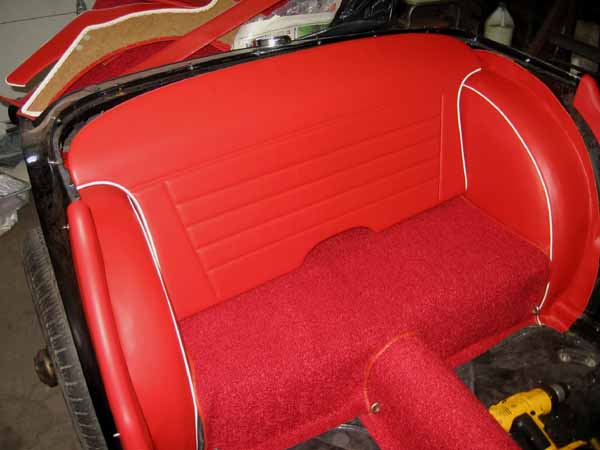

I finally realized why I was having trouble getting the rear panel into position. The fuel tank and hold down straps were preventing the panel from going back far enough. The felt pieces I got from Moss were way too thick (about 3/8" and not very compressible) and they pushed the straps out too far. I pulled the straps off, replaced the felt with some much thinner stuff, moved the fuel tank back as far as possible (about 1/4") and bolted the straps back on. It gave me enough room to get the panel in. It ain't perfect, as there are other fitment issues, but it's something I certainly can live with. I'm working on the rear cappings now, and then the doglegs. I'll post pics when I get all that done.
OK, a pic with the doglegs and all the cappings on. I'm pretty happy with the way it came out. I'll finish the carpeting, and it's on to the doors... :thumbsup:
I don't know why the red looks so bright when I take the pics. It doesn't look that bright in the garage. The flash must have something to do with it.
