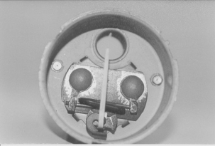

[ QUOTE ]
Is the ammeter internally fused?
[/ QUOTE ]
No, there is nothing between the two terminals except a short piece of wire, formed into a loop. The needle is magnetically coupled to the loop. The ammeter is a short circuit to the power wiring.
