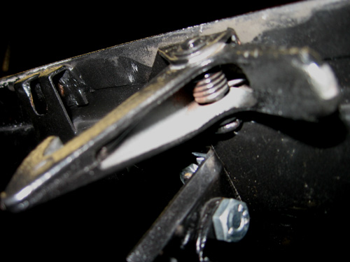

Can someone post a poc of the safety latch attached to the hood? I have the latch but I think there must be a spring any maybe another part I don't have. And it doesn't show any detail in the big 3 parts books or the TR manual (which shows TR2). Thanks in advance.
I've got one pic that shows the spring...sorta what's on a clothes pin. One of the arms of the spring presses against the latch, and the other one against the hood....hope it helps.

Thanks Art - the pic is the right piece but almost <span style="font-style: italic">too </span>close. Is that a pin through the spring? With circlips?
My problem is I inherited boxes of parts - I need to know what I'm missing so I know what I'm looking for....
Thanks in advance,
Here's a couple more views.
Mine is probably aftermarket...It doesn't have surclips...both pivot points are
just swagged-down pins.
Frank C.
These pix are so great! Thanks guys. (But my bad news is I'm missing more than I thought).
Now a question for the purists: painted or not?
Mine is original and unpainted. Check the judging guide and see what it says.
