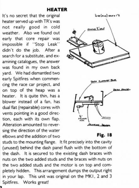

Given my past experience with the stock unit; I'd go the aftermarket route. Or at least try Bob Schaller's suggestion of an early Spitfire heater box.

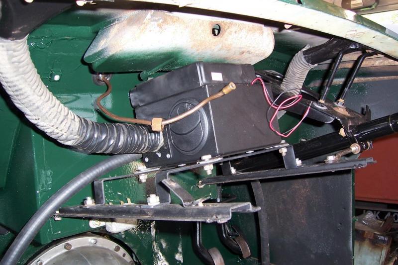

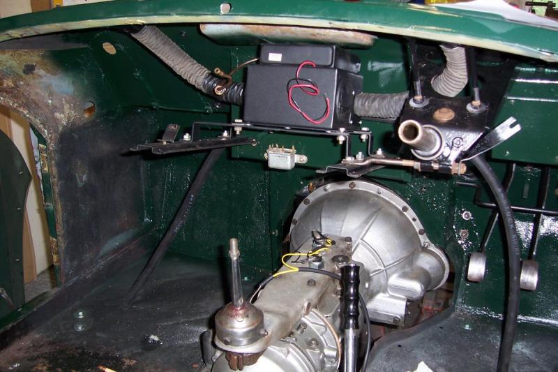

Here is how I used the Maradyne...
The unit as shipped:
I made a cardboard mock-up to trial fit and plan needed modifications:
I had to rotate the body 180°, drill those big holes and add elbows and connectors on the input & outlet:
The unit in place - the core was rotated so the 'door' and the tubes would be on the same side:
Less obvious from a more normal point of view:

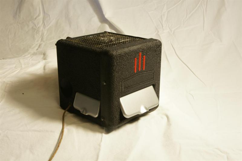

As an aside, that Maradyne heater has a lot of history. The original design goes back to the Hupp company, which is a direct descendant of the company that made the Huppmobile car up to about 1938. After the car business went kaflooey, the reorganized and were a manufacturer of industrial products like heaters until 1991 when bankruptcy hit. Maradyne continues on with spme of the Hupp designs, including the Tucson 5000 series.
How do I know all this? When I got my 1940 Buick a few years ago, it had a Hupp aftermarket unit installed. It was an ugly gold hammertone that screamed late 1950s. So I pulled it out, rebuilt the 6V motor, stripped the body, and repainted in black wrinkle more in keeping with my car's vintage. The reason I did all of this is that the heater is visible to the car passengers. When I found out its lineage, further checking revealed the Tucson will directly drop into place in my car using the same firewall openings. But I like the way the old one works!
Cheers, Dave
