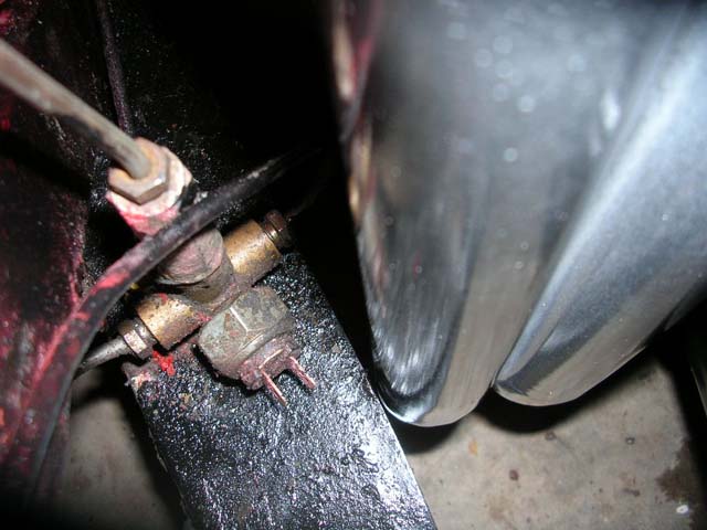

I remounted them tonight and tightened the bottom bolts first followed by the top bolts with manifold. Then I put my feet on them pushed toward the engine with everything I had. I'm about an 1/8 to 1/4 inch off the frame and about a half inch off the engine. Is this ok?? I think so as the engine will torque the other way. Is it going to come back after I start it and it heats up?? See attachment picture.. Maybe I'm just looking for something that is not going to be there... If it doesn't touch should I feel comfortable??
Roy, The edge of the frame at that point looks like the inside of the u-channel. You can just grind a little radius off the edge of the frame part that skicks out toward the header to get more clearance. If the frame inside edge faces away from the header, then you can't grind but it looks like it's the other way around.
Yea, I think I could grind off a little as this is the cannel side... May go with that with what I came up with tonight...
