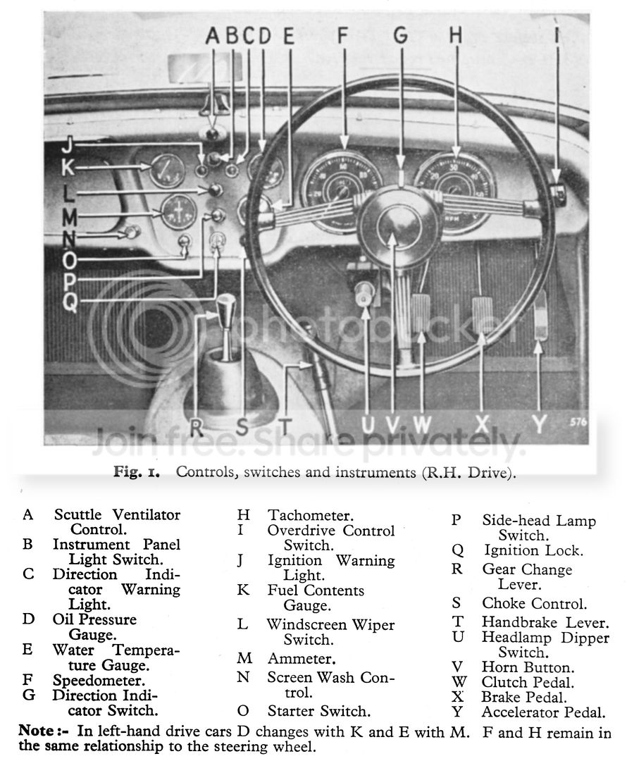

I need to re paint the gauge needles. What should I use? Also, what is REALLY the proper gauge/switch arrangement for my 57. Every where i look, I see something different.
As Randall showed, the important gages, oil and temp were closest to the driver whether here or in England.
At TS 29098 the speedometer went over to the right side on left hand drive cars, so passengers could read mileage readings for rallys. Was not swapped in England though, no need. (or so the "Book" says) The switches were never changed on either side of the pond, choke always on the right with the carbs of course.
<span style="font-size: 12pt">Randall's photo covers the gauges correctly, but there is a conflict on the switches, panel & wiper.
TRA Concours judging standards states TR3 wiper switch on top, panel light switch below, which is contrary to any TR3 (early or late) that I've ever seen.
However, when the Rheostat panel switch was introduced
(somewhere around 60K)the panel light switch was definitely
below.
The facia was modified to accommodate the larger neck
on the rheostat switch in the lower position.
Piggot's latest sidescreen book says the the panel light was on top thru the 3B series, which I disagree with.
Re paint: I mask it off & use flat white quick dry spray.
Interesting, another error in the TRA guidelines and in Bill's book(s). I am quite positive that cars with the switch for the dash lights, had that switch on top; and that cars with the rheostat had it in the second position.
The problem was that the rheostat would not fit in the top location. Nor would the early switch for the optional 2-speed wipers. Note how the lamps for turn and ignition are closer to the top switch location. They extend farther out on the back of the panel, so the relatively slim SPST switch used for both panel lamps (on earlier cars), and single-speed wipers, is the only thing that fits in that location.
Oddly, the wiring diagram in the 'Practical Hints' shows a RHD layout with the panel rheostat in the middle but... the H2O temp gauge at top left and fuel guage at bottom right.
Actually, it depends on which version of Practical Hints you look at. The 4th edition shows the dash light switch in top position, in both the wiring diagram and Figure 1:
