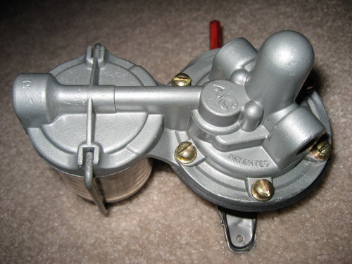

I had to revive this thread to close it out - based on what I read, I decided on an original AC rebuild. I found a crappy old one on eBay, bought it and sent to "Then and Now" Automotive for rebuild...the pic shows the finished product. I wish I had taken a "before" pic to show the difference. Looking forward to installing this!
