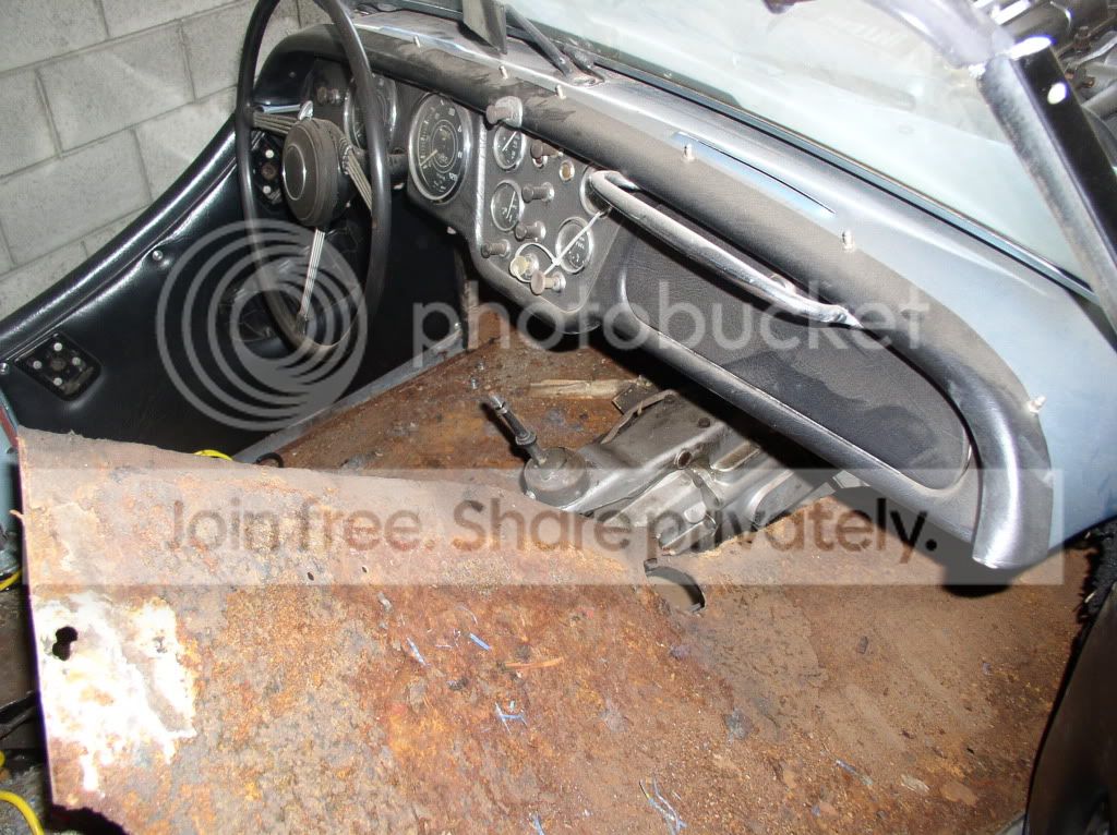

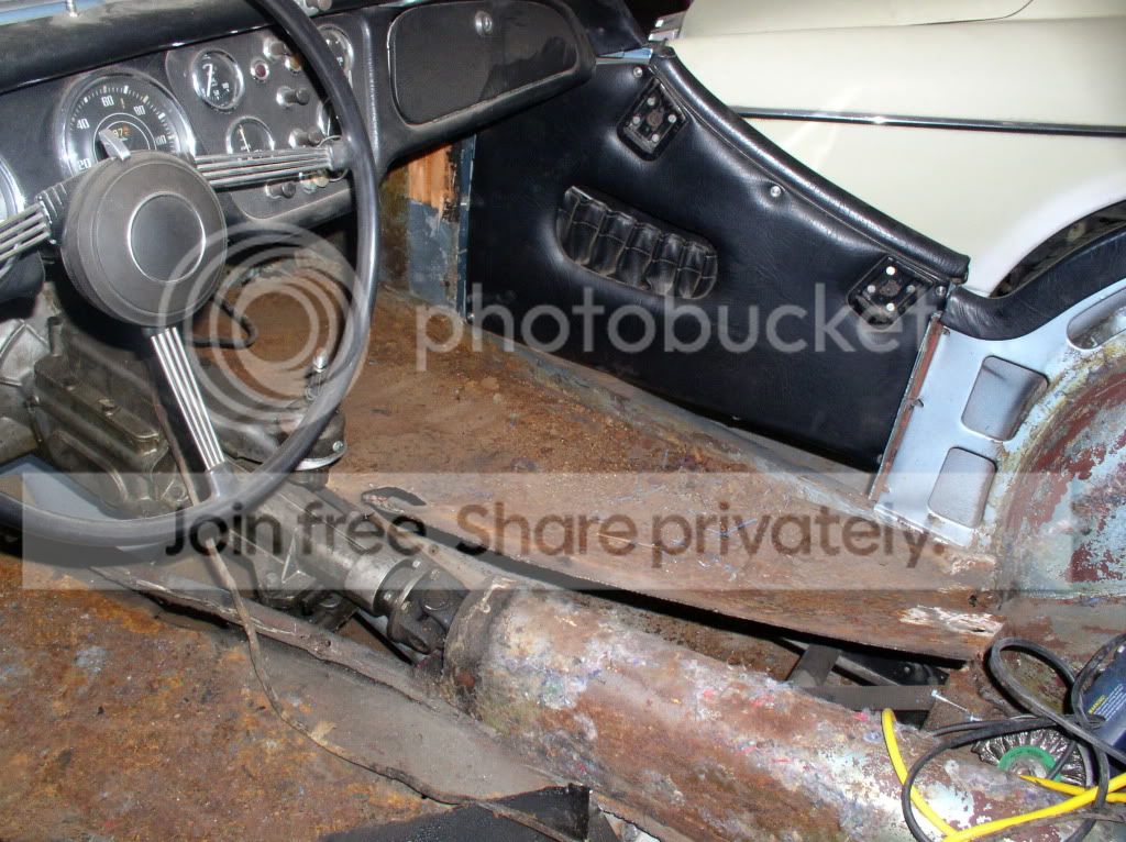

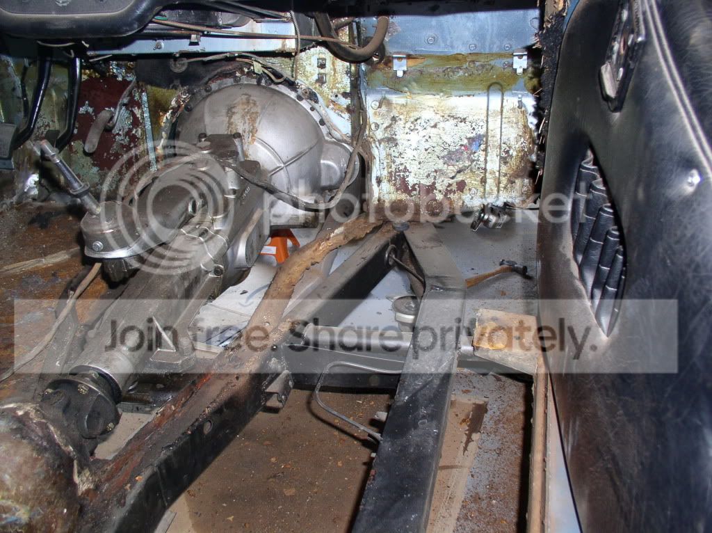

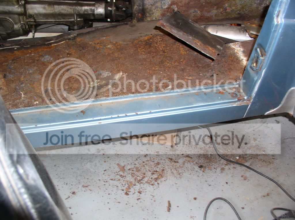

So this represents about 3.5 hours of going at it. Got the passenger side on off, but the driver side isn't quite there yet (mainly because my cutting disk started to wobble on it's mount and I had visions of it launching itself into my chest).
BUT....

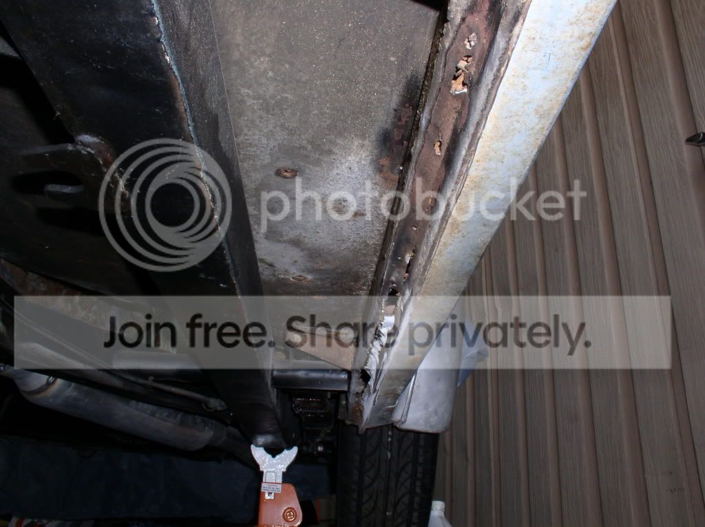

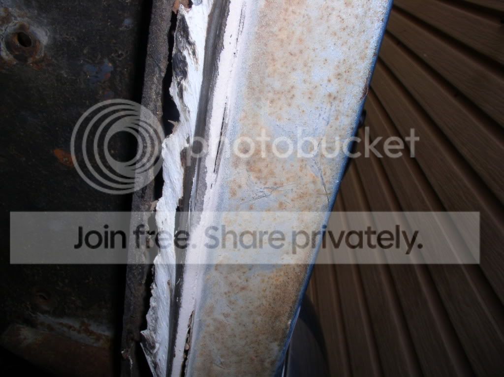

Look what I found under the passenger side floor...not good.
That white stuff is bondo.

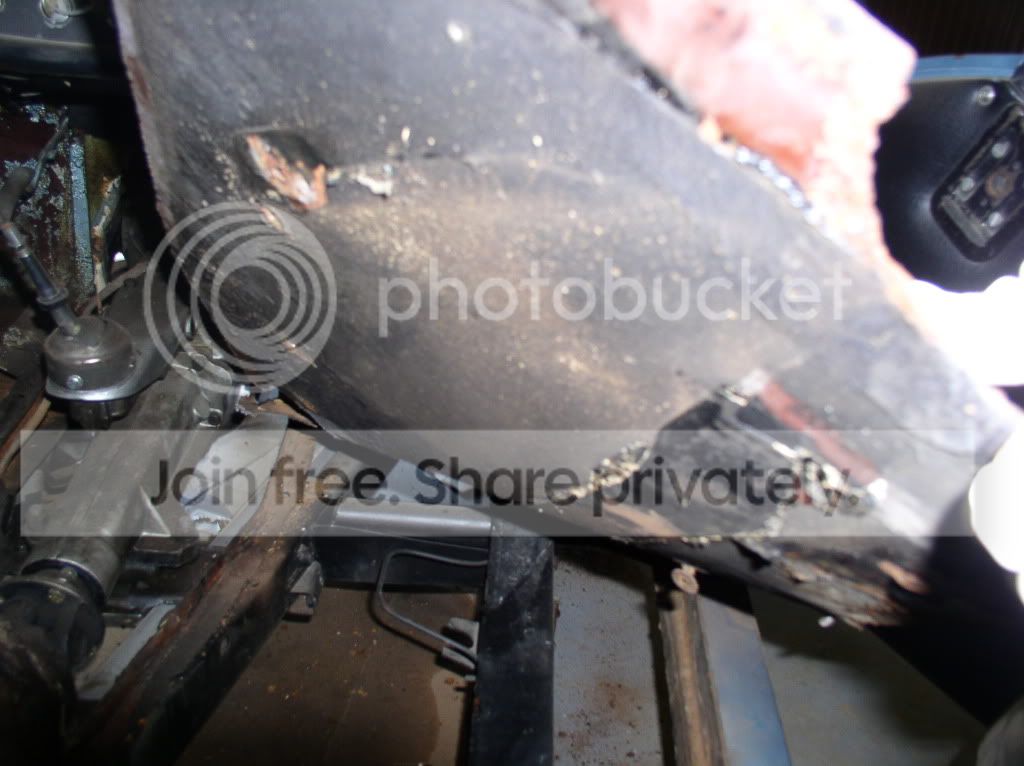

Nearly all of the bottom of this rail is toast...

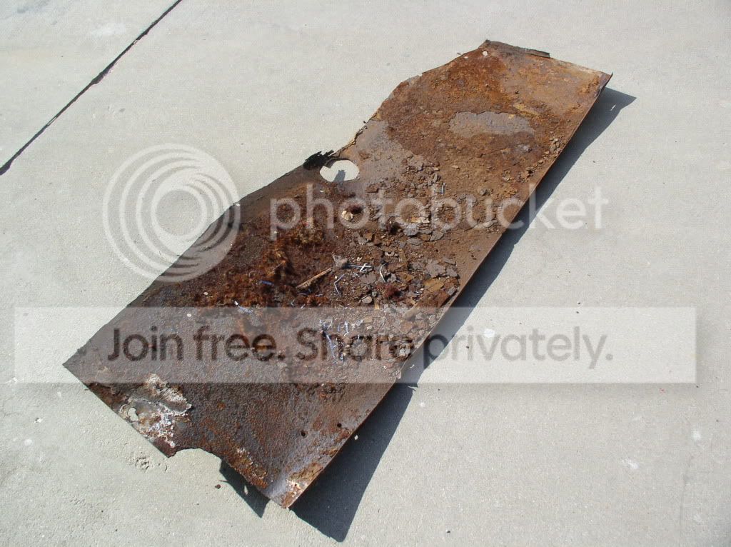

And here is what fell out while I was working on the driver side floor removal;
I think it's a good idea to do one side at a time. The other side will help hold the car inline. The shell of the car is going to be weak from the rust.
