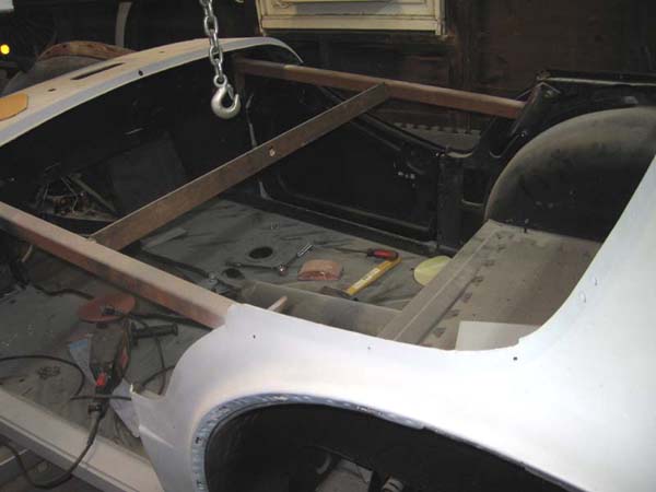

Here's a shot of how I braced mine. The angle iron going across between the braces has a hole in it so I could lift the body tub off the frame. That position perfectly balanced the tub. I lifted the tub using an engine hoist that has wheels. This made it easy to move outside of my small garage while I worked on the frame etc.
Art,
How did you calulate the position of the cross bar and the hole so that it was balanced?
I made a good guess... :laugh: It is very close to the center of the tub. The hole is in the center of the cross piece. Remember, this is the tub without any of the panels on it. No wings or lids or apron...although I did have doors on every now and then to check fit, but they didn't affect the balance much at all.
