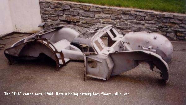

There was so much dum-dum sticking it all together, I had a really hard time to get the wings un-stuck. In fact, most f the flanges on the rear fenders as well as where the captive boxes are hidden inside had rusted away. I had to re-built all that.
In the photo, the front clip is totally separate from the rear clip.
