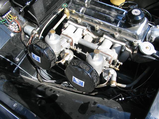

I can't remember about the studs but I think that the nuts could be steel or they could be brass. As for painting, I did mine with high temp silver paint from Hirsch 17 years ago and it still looks good. See the attachment.
