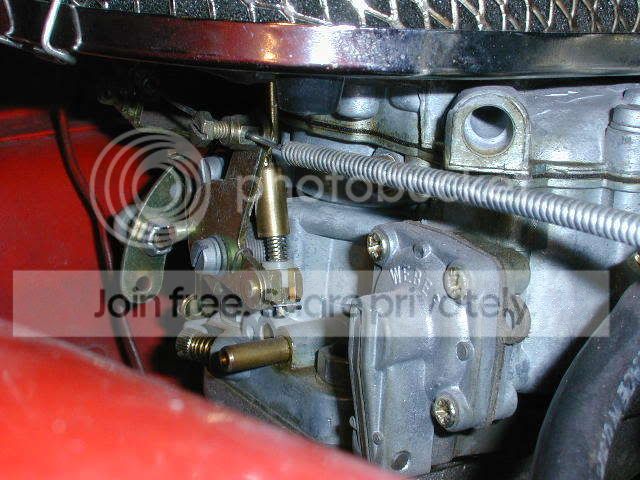

I had DGV's on my 3 for 3 or 4 years then went back to SU's If I remember correctly I bought a bicycle brake cable and put my regular choke cable pull knob on it. I wish I had a better picture of both DGV's.
"Oh, I see" says the blind man to his deaf dog....Let me get this straight, you didn't need a choke cable with two cables...Just one cable that was hooked in tandem to each carb?
