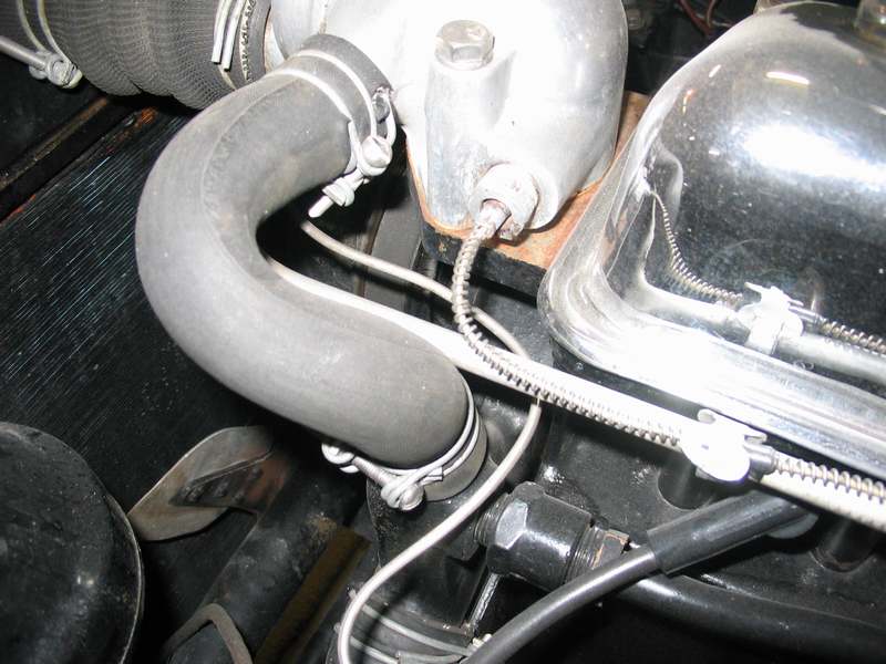

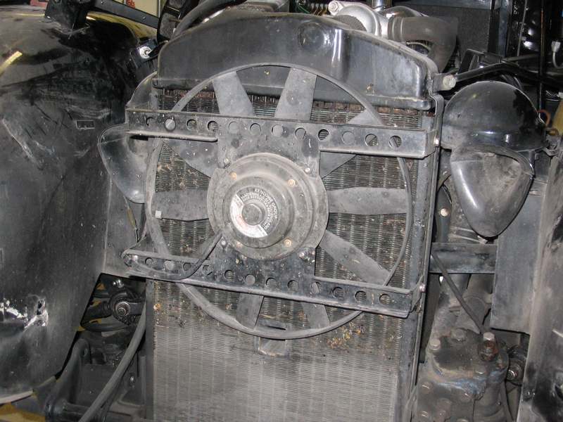

Before I installed an electric fan in my TR3A, the temperature indicated on the gauge would rise to 235 degrees in about 5 minutes. I never tested this at idle. It would rise when I was stuck in traffic. I suppose that's like "at idle". I brought it down a bit by putting in the cardboard air deflector (it's a very early 1958 TR3A and they only started to put the air deflectors into TR3As about June 1958). I had the radiator recored and set the timing correctly so the combustion would be more efficient. I installed a 12" Kenlowe (UK) fan in 1992 and I flick on the fan with a switch under the dash every time I see the temperature rise - it's always when I'm stuck in traffic. If it has aready risen to - say 215 degrees - the fan brings it right down to 180 again in less than 3 minutes. It is a pusher fan in front of the radiator and I still have the original fan mounted on the front end of the crankshaft. My water pump has a new housing and a new seal (1990), but the same original impeller with 97,000 miles since then on the pump and 180,000 miles on the impeller. In 1990, I blocked the bypass hose with a brass plug with a 1/8" diameter hole drilled in it to allow the air to rise when filling the coolant. I run 50-50 antifreeze.
